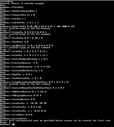

    Thank you for your reply. I hope mmWaveStudio is not used to obtain the raw ADC data, so DCA1000 seems necessary.
    My. cfg file seems to have no errors configured in the millimeter wave sensor estimator, but it cannot start the radar after loading in the mmWave Demo Visualizer.
    My configuration is as follows:

  • Hello Gary,
    Do you happen to own a MMWAVEICBOOST? With a 6843ISK + MMWAVEICBOOST you can get runtime debug and error messages which can give a detailed error code on where sensor start crashed.
    If you do not have a MMWAVEICBOOST, what I would recommend is start with a known working "default" configuration, such as one found within the MMWAVE-SDK installation, and slowly change parameters one by one until it does not work. Based on the config you have sent, I am guessing there is something the sensor does not like between profileCfg and frameCfg. Does that same exist config work when only numLoops is changed?

  • Hello Gary,
    Your cfg has "-" all over the place and so I cannot test it and see what the error is. I tried guessing how it was supposed to be but could not proceed. Can you please provide your config as you send it to device?
