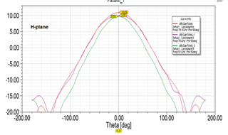

  • Hi Manoj,
    Thank you for the details. We have not done any testing for detection of drones - could you clarify which TI-provided specs you are comparing your results against?
    FoV is defined by the physical antenna array. For more information on this, please refer to this similar thread: https://e2e.ti.com/support/sensors-group/sensors/f/sensors-forum/1093172/iwr1843boost-awr1843-medium-range-radar-demo
    The FoV, as provided in the EVM user's guide can be determined from antenna radiation patterns (Fig 11-12). These patterns are derived from testing the EVM in an anechoic chamber using corner reflectors.
    Thank you,
    Jin

  • Hi Manoj,
    Thank you for the clarification. The FoV provided in the threads is based on threshold values from the radiation patterns. For example, +-50 degrees horizonal FoV is based on a 6dB drop in gain compared to at 0 degrees. We limit the FoV provided based on these thresholds since objects at large angles will have lower signal strength (SNR) and may not be detected.
    It is possible that the drone used in your testing may be highly reflective, enabling higher SNR and detection at larger FoVs than provided.
    Without considering signal strength, the FoV limit of the angle estimation technique alone is +=90 degrees for the antenna geometry of the board. Please refer to this thread: https://e2e.ti.com/support/sensors-group/sensors/f/sensors-forum/988784/awr1843-awr1843-fov-for-mrr-srr-and-ussr
    Thank you,
    Jin
