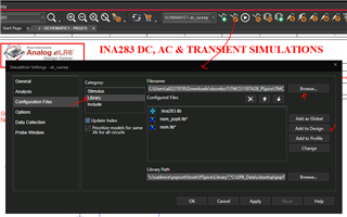

Sometimes you cannot right-click the "Model Libraries" to add the .lib. To get around this, click the "Edit Simulation Profile" and navigate to the following window and add the .lib file to the Design Configuration files.
