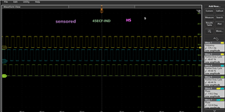

  We are using 3 qty DRV5012AEDMRT hall sensor  in our flat BLDC motor for commutation purpose. There are placed 120 degree apart. Motor is of 16 pole magnet (8 pole pair).
distance between hall sensor surface and magnet is 1.6mm
when we drive motor using sensored driver we observed it is taking very high current and when we driver same motor with sensorless driver it consume very less current.

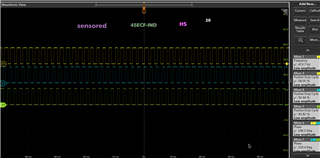

With sensored driver we observed hall sensor waveform on oscilloscope and found that at low speed , the duty cycle and phase shift is with in spec i.e 50% and 120 degree respectively.
As we increases speed the duty varies and phase shift also.
for reference refer below snapshot of hall sensor at different speed. Can you please help us to understand what will be root cause for this and how can we improve duty cycle at higher speed.
1. speed -1300 rpm
2. speed -5300 rpm
    Thanks for posting your question to the Sensors forum.
    With 5300 rpm, the number of poles passing the sensor per second is approaching the sampling frequency of the device -> 5300 rpm * 16 poles / 60 seconds = 1413 poles per second. The device sampling frequency with SEL pin high is 1665 Hz / 2500 Hz / 4700 Hz (min / typ / max). Generally, the device sampling rate should be at least faster than 2 times the the number of poles per second, but ideally this number is 3 times, 4 times, or even more than the number of poles per second.
    Additionally, at ~5300 rpm, which is ~88 revolutions per second, each revolution has 16 poles (8 electrical cycles), so the electrical frequency is ~704 Hz, a period of 1.4 ms. The DRV5012 in 2.5 kHz mode has a typical sampling period of 0.4 ms, which is ~28 % of the electrical period. Generally, the maximum timing error should be kept under 10% to ensure the BLDC motor spins, and timing error can reduce motor efficiency.
    More information on the calculations above can be found in the Application and Implementation section of the DRV5012 datasheet. For a device with a higher sensing bandwidth in a similar package, you could try the DRV5011 (30 kHz bandwidth).
