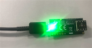

Hi team,
While OPT4060 operating after clicking "Start Capture", the green LED on the mother board doesn't turn off, even it is described in EVM to be disable.
It disturb evaluation/measurement.
Could you please let me know how to turn off.
I also consider to short LED (LED 2pin and 4 pin shorted). Does it damage the device because of sink current of P1.3/TA0.2 pin?
Sink current is
LED ON : (3.3V - Vf) / 300ohm = 3mA
Shorted : 3.3V / 300 ohm = 11mA
