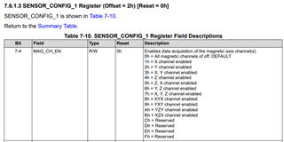

    Just as a quick sanity check, have you enabled the MAG_CH_EN bits, shown below?
    ~Alicia
  • Hello Alicia, thank you for your response! Actually I did not enable the MAG_CH_EN bits initially, however, now I have incorporated them yet I still have the same issue. I am attaching the modified code, maybe that could help rectify any error that I might be missing!

  • Hi Asad,
    I noticed that you have set the register address for SENSOR_CONFIG_1 to 0x6B. I believe that this may be a mistake as the register address for SENSOR_CONFIG_1 should be 0x02.
    ~Alicia
