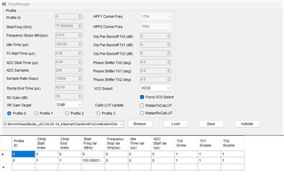

    I just tried reproducing this on the EVM (note:this was tested on single chip EVM, but for this experiment I don't think that should have an impact). Attached are the images of my configuration. I did not see any error trigger during framing.
    1 profile with two chirps, second chirp has 150MHz start frequency offset. VCO2 selection is forced:
    2 bursts with second burst having chirp start index offset of 1 to use the second chirp:
    Can you please confirm which firmware version you are using?

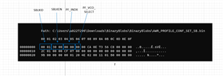

    I've tried multiple times to upload binary blobs that are the profile and frame sub blocks we are sending, but the e2e interface won't allow them to upload. The purpose would be to compare against what binary you're sending for those sub blocks. Is there another trick within the e2e tool by which I can get them to you?
  • I looked at the .bin file, it does not seem like VCO select is being applied. I see a value of '00' indicating that both the FORCE_VCO_SEL and VCO_SEL bits are being set to a value of zero.
    Adrian
  • With this, I was able to discover a bug in our binary payload generation! Problem resolved. Thank you.
