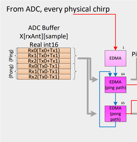

i am reviewing motion and presence detection demo, but  i have a one question.
according to code, adcbuffdata size is numofadcsamples * numRxAntenas * 4
params->ADCBufData.dataSize = gMmwMssMCB.profileComCfg.h_NumOfAdcSamples * params->ADCBufData.dataProperty.numRxAntennas * 4 ;
(motion_detect.c 1234 line)
i don't understand number 4.
i saw that adc buffer will be [rxAnt][Sample] by Real int16 in MotionPresenceDetecionDemo_documenatation.
variable is int16 , thus, i think number will be not 4 but 2.
please share your opinion.

    Yes, it looks wrong. Maybe it meant for total buffer size (including ping and pong buffer below).  The figure comes from figure 16 inside motion and presence detection implementation guide located at C:\ti\MMWAVE_L_SDK_05_03_00_02\docs\MotionPresenceDetectionDemo_documentation.pdf
    On the other hand, I did not see this params->ADCBufData.dataSize used anywhere else.   Please give me another two days to find more information.

    This following line is wrong (from old SDK), and dataSize is not used anywhere.
    The EDMA data transfer size is programmed as below inside rangeProcHWA_ConfigEDMA_DataIn().
    //real ADC samples only supported
    bytePerRxChan = DPParams->numAdcSamples * DPParams->numRxAntennas * sizeof(uint16_t);
