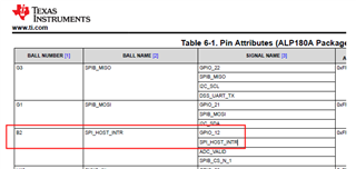

My customer asked if the following pin is only avialable GPIO with interrupt support.
Can you please let me know the interruptable GPIO list?

Hi Jack,
Any particular ball can have multiple signal. i.e. it can used for output from any one signal at a time from multiple signal. In the given diagram ball B2 can be used for SPI_HOST_INT or as GPIO_12. you can have interrupt at any given gpio of your choice.
