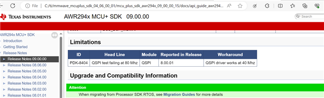

I found the 80MHz QSPI is failed in SDK 08.00.01, can you tell me the details about this test?

Can you help explain the reason why 80MHz QSPI can't be used in 2944? And what test we did for 80MHz QSPI?

Hi Shawn,
we have done the following tests to check the qspi functionality -
1. qspi_flash_diag
2. qspi_flash_dma_transfer
3. qspi_flash_transfer
the latest SDK supports 80Mhz spi clk frequency.

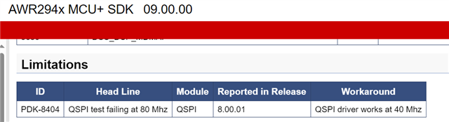

Hi Shruti,
We still see this issue in SDK4601, can you help check if we have fixed this issue or just forget to update the README?
Shawn
Hi Shawn,
Yes, there could be some documentation issue. I think we have fixed this issue in the latest SDK.
Shruti
Hi Shruti,
I believe MCU PLUS SDK4601 is the latest version we can download from ti.com, so does this SDK has fixed the QSPI supporting problem or we need to wait for next SDK release?
Shawn
Hi Shawn,
Yes, I believe that this version supports the same.
Shruti
