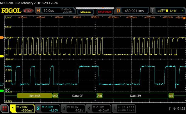

I am having I2C problems in which my i2c line seems to get stuck. The state where it's stuck is CLK held high and DATA held low.
This has consistently happened after writing to the Configuration Register (01h) and reading back the 16-bit response. In the screenshots I took from the oscilloscope it looks like the data values are getting through but seem to have a problem getting the NACK and stop condition from the master. Is there any reason for this failure or how to avoid it? The problem is very inconsistent.
Other things to note are that are 4 INA233 on the i2c bus, an ADXL355BEZ accelerometer, and this TMP117 temperature sensor.
In all of the failures, the temperature sensor was always the peripheral that held the line.
YELLOW IS CLK
BLUE IS DATA

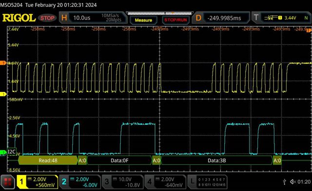

See failure waveform:
This is the successful transaction earlier in the loop:
Any ideas or advice would be helpful
  • In the datasheet (7.5.3.1.7) The Timeout Function says that "the SDA line is held low by the TMP117 for 35 ms (typical) between a START and STOP condition. The TMP117 releases the SDA line if the SCL pin is pulled low and waits for a START condition from the host controller". We have a process that can bit-bang to attempt to fix this holdup but currently, we see this issue has something that needs to be resolved outside of doing a bit-bang. There is nowhere in the datasheet that states why the TMP117 would hold the line low.

    This appears to be read transactions you are showing, and I see that after the data is returned on the bad reads the acknowledge bit is low. You need to force a NACK from the controller at the end of a read transaction. The TMP117 should have no problem recieving NACKs from an I2C controller, you may need to look at your controller and see if you are forcing the NACKs correctly/consistently at the end of the read transactions.
