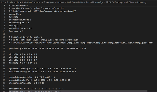

    Are you not sending the same configuration file with the CCS built binary versus the prebuilt one? You can open a chirp config file in a text editor of your choice and it should look like this.
    mmw_mss.cfg and other ".cfg" files generated by CCS share the same extension name, but are completely different. The chirp configuration as shown above is essentially a text file. The source code for the visualizer is in the same location as the executable. You can run the visualizer from source and it running the same by doing "python gui_main.py"

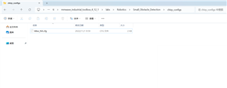

  • Hi Pedrhom, I did the same configuration file with both the prebuilt binary and binary generated after I built the MSS and DSS projects, the configuration file worked with the prebuilt binary and I was able to see results in visualizer, but it didn't work with the binary generated from built MSS project. I only found one cfg file in the chirp_configs directory and it is different from the one you showed in the above reply, I don't know if I need to download and install a different version of industrial toolbox, but this config file worked with the prebuild binary, I think it might be fine.
    Here is what I saw in my chirp_configs directory:
    Only one file called 68xx_ISK.cfg exist in the directory: mmwave_industrial_toolbox_4_12_1/labs/Robotics/Small_Obstacle_Detection/chirp_configs. The cfg file content is:

    You are using a very old version of the toolbox. Please refer to and download the newest version of the Radar Toolbox.
    https://dev.ti.com/tirex/explore/node?a=1AslXXD__1.30.01.03&node=A__AFBXnwiM2XV37eEtzWKflA__radar_toolbox__1AslXXD__1.30.01.03
    Pedrhom
