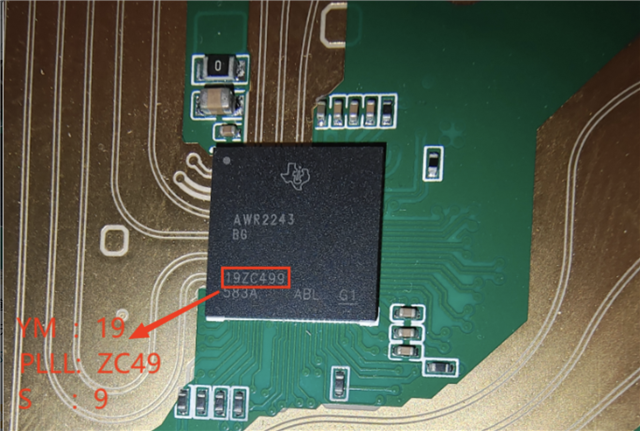

AWR2243: Device map 1 : Channel Config failed with error code 282
Part Number: AWR2243
When I was configuring cascading, when I reached the channel configuration step, an error message was displayed as shown in the figure below, and its related meaning is explained in the quotation marks in DFP. I want to know why this problem occurs? And how to solve it
Error 282: "Device variant does not allow cascading but API is issued to enable cascading mode"
