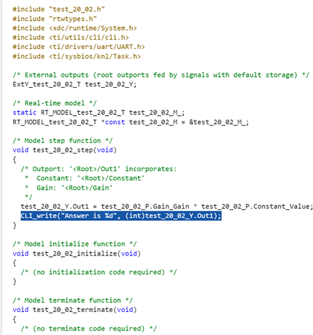

I am using the AWR1642BOOST and attempting to display the output on the console for a gain block. My setup includes SDK version 3.06_01_00-LTS, XDC tools version 3.62, the latest version of CCS, and BIOS version 6.73.01.
When I try to print the output using the UART_write command or CLI_write command for my specific code, nothing gets printed. However, a line from the cli.h file that I have included does get printed.
I have used the following commands:
System_printf("Output is: %d\n", (int)test_20_02_Y.Out1);
CLI_write("Answer is: %d\n", (int)test_25_01_Y.Output);
I have also tried uart_write, but in every case, only the output from the cli.h file is getting printed on the console.
What command should I use to print my output on the console?
Note: I have included the necessary header files, and the binary is being generated without throwing any errors.

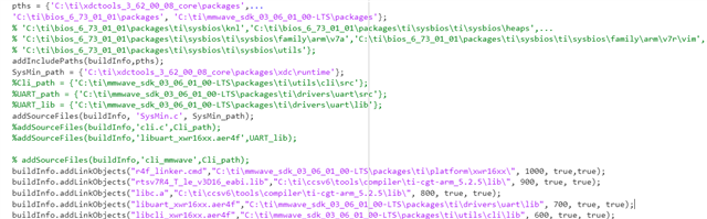

    These are the lib files I have included to generate binary in this priority order:

  • Hello Asim,
    Is the CLI_write API not functional for you?
    The CLI_Write API is the one that you should be using because it internally calls the UART_write itself and it should be working.
    System_printf only works with your Debugger console view as it writes it over the JTAG and not the UART.
    You should onyl be using the CLI_Write as in that function it properly sets up the UART and then prints it over the serial terminal.

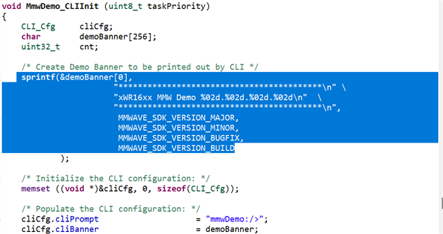

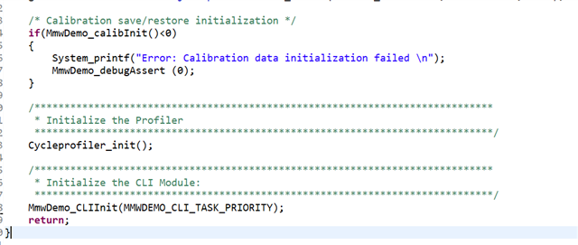

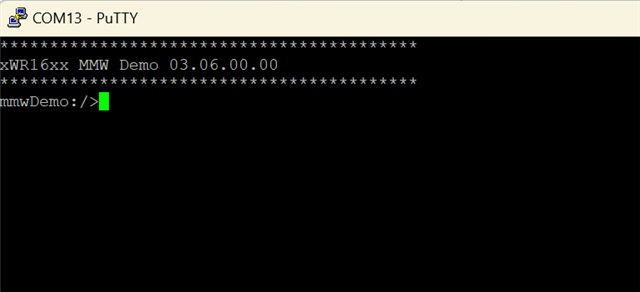

  • The CLI_write prints the string 'xwr16xx mmWave Demo' from the cli_main file using the mmwave_cliinit function as you can see from the screenshot attached above.
    But it is not printing the output I am trying to print.
    I have done linking of the cli library file.
    And from there the main file is calling the mmWaveDemo_CliInit function and only this much is getting printed.
    But what I intend to print is not getting printed.
