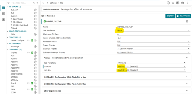

  • Are there any specific pins for I2C protocol on the CC1352 board, for SDA and SCL lines, can I use them arbitrarily as GPIO pins?
  • You can set up which pins you want to use for the I2C (and UART) freely in sysConfig. Pins can either be configured to act as GPIOs, or be connected to a peripheral, like I2C

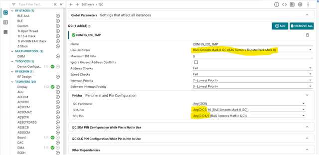

    If you look at the I2Ctemp example in the SDK, it assumes that you have a BP-BASSENSORSMKII BoosterPack connected to your LP.
    In that case, the I2C signals is routed out on DIO5 and DIO4, which will be the pins that are connected to the sensor board:
    You can change "Use HW" to None, and then select the pins you want to connect to your sensor. When usng a LP you need to select between pins not connected to any other peripherals on the LP:
