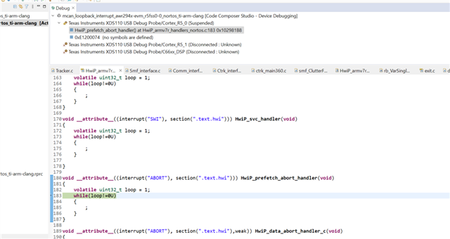

Hi TI Support,
when meet this issue,we should watch which Registers to Check reasons.

Hi Cheryl,
This situation defines the application is in abort state, that is some unexpected situation from which the CPU cannot recover or bypass the cause.
There is no specific register to check the direct reason of the CPU abortion.

Hi TI Support,
In the case of stack overflow, I can know from which register.
Stack overflow and CPU abortion condition are totally different.
For CPU abortion you can check Abort Registers in CCS > Registers window.
Here I can see your R5F core has gone to prefetch_abort _handler, you can consider checking AWR_MSSCPUFAULT_STATUS_GET_SB structure for more information on MSS CPU fault.
Please go through the Radar-Interface-Control document(mmwave_mcuplus_sdk_04_04_01_02\mmwave_dfp_02_04_09_01\docs\mmWave-Radar-Interface-Control.pdf) for further details.
