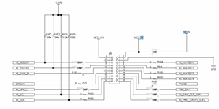

---> I am currently giving power to this EVM as usual, but I am not able to give power like this all the time, so is there any other way to give it directly?

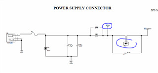

This board can also be powered through the BoosterPack header pins. (see page 6 of the EVM User guide)
https://www.ti.com/lit/ug/swru508c/swru508c.pdf
as well as the schematic for reference: https://www.ti.com/lit/zip/sprr251
--> In user manual it says, if we connect the launchpad board on the EVM, there is a need to give power to the EVM.
but is there other way like give 5V directly using any wires to the EVM ?
Sankar -
Referring to the schematic from link above - aside from the power jack, you can provide 5VDC via jumper P5
or you can populate R115 and provide via Pin 2 of J6 (BoosterPack header, previously mentioned)
