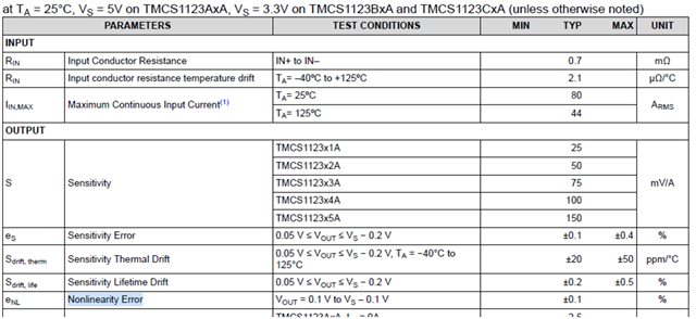

I try to recommend this device in PDU project, could you help check the questions below:
One question is about Non-Linearity Error.
My understanding is that if Non-Linearity Error is ±0.1% and I do a single point calibration, does that mean that the output of the HALL IC achieves 0.1% accuracy under OUT Voltage Linear Range?
