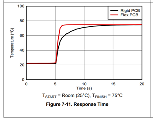

Regarding response time, can I consider the parameter (tLIQUID Response Time (Stirred Liquid)) to be represented by Figure 7-11?

    Lastly for response time, yes, the tLiquid parameter is associated with Figure 7-11.
