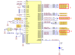

Customer would like to configure AWR2944 via mmw studio,
May I know the minimum interface to configure AWR2944?
Will the interfaces in 3 red blocks be sufficient to configure the device?

Hi Experts

Hi Ken,
Yeah, that's sufficient.
Key points -
