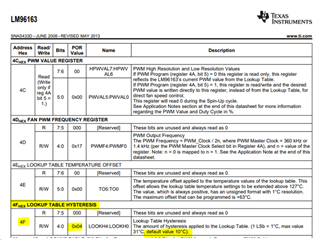

Hi expert,
May I check with you why REG 0x4F the POR value is 0x04 but why default value saying is 10C instead of 4C?
Allan
Hi Allan,
I agree that a POR Value of 0x04 does equate to 4C, not 10C. The 5 bits are also consistent with a max value of 31C. This mistake is in the LM96063 datasheet as well, but the LM63 datasheet omits it.
