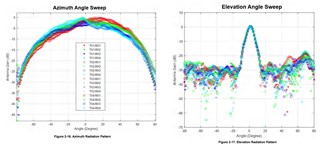

Can you provide antenna azimuth/elevation pattern files as CSV, mat, etc.?

    The antenna pattern is provided in the AWR2944EVM Userguide. Posted the same below.
    I'm not sure what data it is that you require in a CSV or a MAT file, but for all your possible requirements, you should be able to look at the attached image and write an array as such for your required processing. Please let me know if you require more information or if I missed something.

    I want to know the antenna beam pattern, not the antenna design.
    The user guide only shows antenna beam pattern graphs.
    Can I get a csv or mat file of the antenna beam pattern graphs above?

    Thanks for clarifying. Unfortunately, we do not provide the data files for these plots. We expect customers to refer to the plots as they have been published in the user guide.
