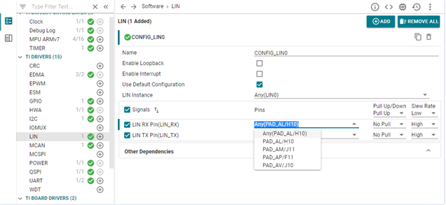

We could not see the explanation about register setting of "PINCTRL register" in the "Table 23-15 pin Muxing Table" in the Techincal Reference Manual Chapter 23.2 from TRM.
Could you please tell me where is stated. Is there any other documents for reference?
Ito
  • Hey Ito-san,
    In most cases, the pinmuxing should be set through SysConfig for a project. Many SysConfig drivers will allow a user to set the pin out for a given peripheral pin. For example, when adding a LIN instance, the LIN RX pin can be set to any one of the four pins specified in Table 23-15: H10, J11, F11, or J10. SysConfig will also highlight when there are any conflicts in pinmuxing due to two or more driver pins using the same pin out.
