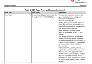

During normal operation, could a low signal on B12 WARM_RESET pin lead to AWR2944 reset?
Or the behavior depends on SW configuration?
Thanks a lot.

The WARM_RESET pin can be driven low from PMIC for diagnostic or can be used as status signal (from the device) that the AWR2944 is going through a reset.
There is also a description of this on page 3112 of the TRM

I found the description.
It's clear about "can be used as status signal (from the device) that the AWR2944 is going through a reset". This is used as output function for status indication.
I don't understand "The WARM_RESET pin can be driven low from PMIC for diagnostic". Could you explain more? Is this used as input function?
