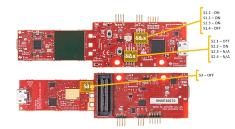

  • I double checked my pin settings of the MMWAVEICBOOST and DCA1000EVM as seen in the picture. These should be configured for ADC data capture.

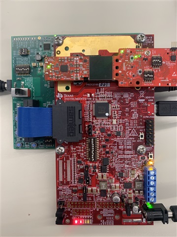

This is my setup:
If any additional information is needed let me know!
    Are you certain that your AOP is ES1? You can check based on the diagram below.
    Did you also check that the AOP's back switch to be off?

    I cannot see exactly, but you have two micro USBs connected as well as the Ethernet cable right? Have you potentially tried different USB cables and Ethernet cable? I have personally came across "MSS Power Up async event was not received" with it being fixed with a different Ethernet cable, and the one I was using before was the one that came with the box so it is very possible.
