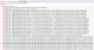

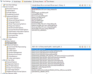

Then, I used this library to replace the original lib track3D awr2944.aer5f library which had some errors.
The image shows the project setting s for modifying the library.
This iamge shows an error when building the project, but the same project using the track3D awr2944.aer5f library or the source code is successful.

  • Hi Ken Li,

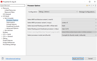

    Can you share the Compiler flags for alg_lib project? Open CCS and right click on the project and navigate to Properties -> CCS Build ->Arm Compiler to check the compiler flags.
    error #16016-D: file "C:/ti/mmwave_mcuplus_sdk_04_04_01_02/mcu_plus_sdk_awr294x_09_00_00_15/source/drivers/lib/drivers.awr294x.r5f.ti-arm-clang.release.lib<adcbuf.obj>" was built for VFPv3-D16 coprocessor support while a previously seen file was built for VFPv4-D16 coprocessor support
    From the logs, I noticed that the floating-point option is conflicting.
    Samhitha
  • Hi Samhitha Bobba,
    I really appreciate your help.
    I found different project settings on the library project processor options and changed the settings to be the same as the original project.
    Now it can be executed normally.
