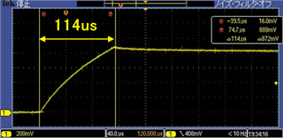

    We measured the VBGAP voltage of our hardware board. We have questions regarding the voltage waveform.
    Fig.1 shows the rising waveform of the VBGAP voltage when a 47nF capacitor is connected to the VBGAP pin.
    Is it correct behavior that the VBGAP voltage increases in two steps?
    Fig.1 VBGAP Voltage (C=47nF, T=+25degC)
    Whether the capacitor on the VBGAP pin is 47nF or 220nF, there is not much difference in the time it takes for the VBGAP voltage to fully rise (Fig.2 and Fig.3).
    This is because if the capacitor on the VBGAP pin is 47nF, the VBGAP voltage will rise in two steps.
    This difference is not purely due to capacitance, so we are worried that it will cause startup problems.
    When the device checks the VBGAP voltage, How many is the threshold voltage and when is the judgment timing?
    Are there any temperature characteristics in the threshold voltage and judgment timing?
    Fig. 2 VBGAP Voltage (C=47nF, T=-35degC)
    Fig. 3 VBGAP Voltage (C=220nF, T=-35degC)
    Yasuaki
  • Hi Yasuaki,
    The two-step rise in the VBGAP voltage in case of 47nF is an expected behaviour. This is to avoid any reliability issues by doing a fast start up and slow start up after settling to avoid any boot failure. If you check the graphs the rise time in case of 220nF at negative temperature increase which wrt 47nF might cause boot failure.
    The validation has been done for 47nF decoupling capacitor across VBGAP across all PVT corners. The threshold voltage and judgment timing are independent of temperature characteristics.
    Ankit
  • Hello Ankit,
    Considering the behavior of the voltage increasing in two steps to avoid boot failures,
    does this imply that a monotonic increase in voltage, as shown in Fig. 3, is problematic?
    Best regards
    Yasuaki
  • Hello Yasuaki,
    The monotonic increase in voltage does not necessarily imply to be problematic.
    Ankit
