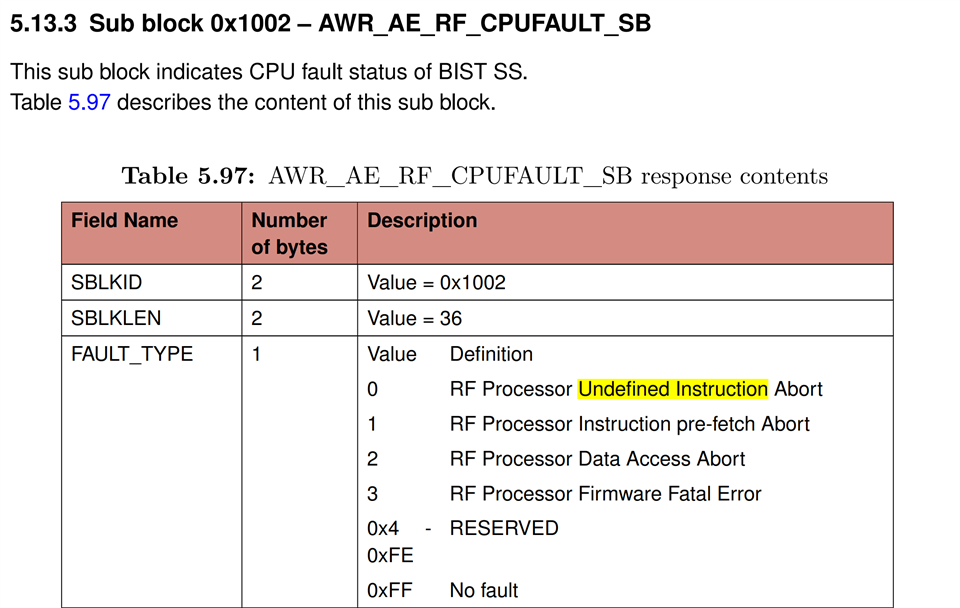

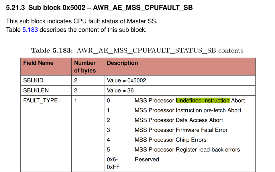

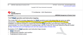

Hello Team,
    I am in need to implement illegal instruction trap monitoring safety implementation.
I have gone through Cortex-R5 Technical Reference Manual section 3.8.6 Undefined instruction
but I am not getting an exact idea on this illegal instruction trap implementation.
Is there any example code about how to configure Undefined instruction and how to know it trapped a illegal operation ?
