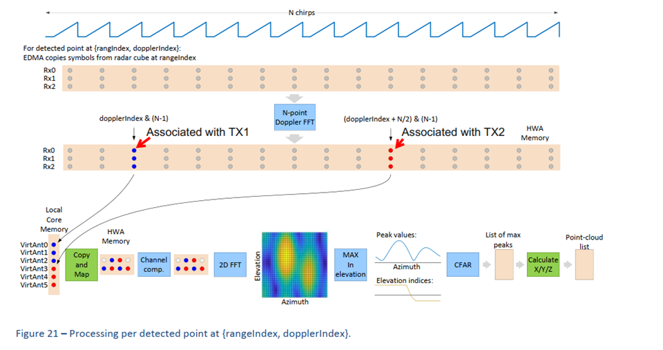

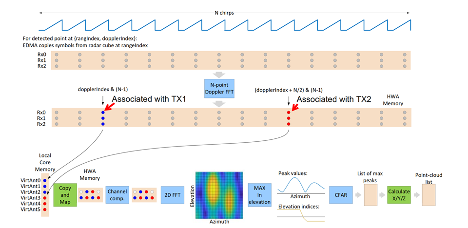

In mmwave demo, BPM decoding is performed later in the chain inside the AoA2D DPU, but i don't find the code about bpm decoding in AoA2D DPU. Coule you please tell the bpm decoding in details?
If bpm decoding in time domain, the steps describles as follow.If bpm decoding after range and doppler fft, how to do decoding on RD Map? Thanks!
