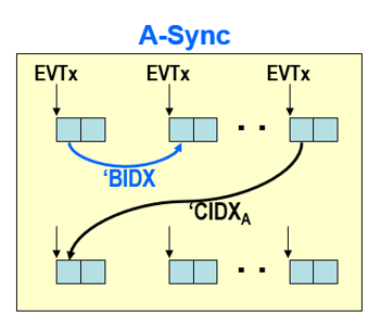

syncACfg.aCount = dpParams->numAdcSamples * BYTES_PER_SAMP_1D;
syncACfg.bCount =MAX(dpParams->numRxAntennas / 2U, 1U) * dpParams->numChirpsPerChirpEvent;
syncACfg.srcBIdx = rangeProcObj->rxChanOffset * 2U ;
syncACfg.dstBIdx = 0U;
For 4 RX antennas, this works out to
syncACfg.bCount = 2;
Does this mean that the second B array is overwriting the first B array in the destination buffer?

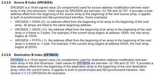

sprugs5b Keystone Architecture EDMA3 Controller gives an example of SRCBIDX being set to 0, and says on page 33, section 2.3.2.8, "SRCBIDX = 0000h (0): no address offset from the beginning of an array to the beginning of the next array. All arrays are fixed to the same beginning address." It goes on to say that the we should refer to the SRCBIDX examples for DSTBIDX.
Can you help me understand what it means that dstBIdx is set to zero?
Thank you for your help.

    Note that for syncA type of EDMA, a new event will be needed for every aCount.   Second, this input EDMA uses ping-pong buffer, and can change the source and destination address every time it is being triggered. So, it probably does not really mean anything that dstBIdx is set to zero.

    It appears that dstBIdx set to zero does what you would expect: the destination address is not incremented between consecutive syncA transfers.
