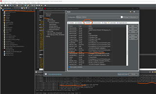

I have modified the "ProjName" from Property-->Bulld-->Variables, but the output file name still the default name.
You can change the appimage name by changing it in the file makefile_ccs_bootimage_gen
This file is executed after the .out is created. Name of the appimage can be changed from this file
