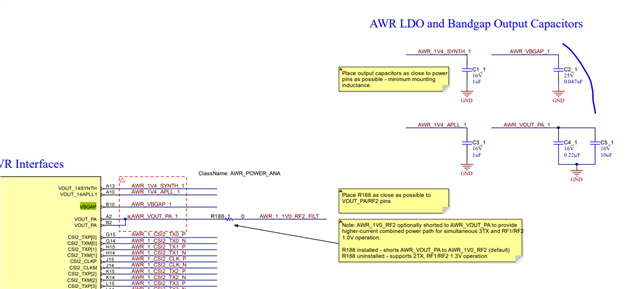

I am using TIDEP-01012. It was working fine yesterday but the device is showing some error issue.
here is the log that i got from mmwave studio.

[15:37:42] [RadarAPI]: ar1.AddDevice(8)
[15:37:42] Status: Failed, Error Type: RESP TIMEOUT
[15:37:47] MSS Power Up async event was not received!
[15:37:47] Device 4 : SPI Connection Failed
