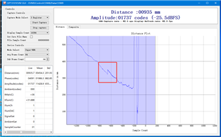

Hi Team:
       The OPT3101 is set to SuperHDR mode. When the distance between the sensor and the target board is tested from far to near, the current channel switching will show a jump from the target distance to far, and it is relatively large;
        This is the configuration:
     This is the distance jump that occurs when I move the sensor, and the distance from far to near is not continuous when switching the current channel;
     How to solve this problem?
    Thanks!

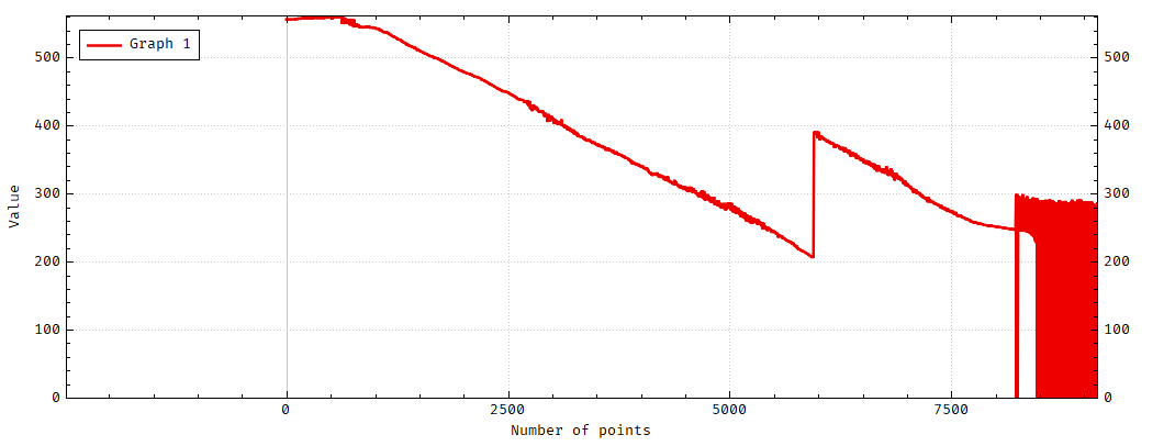

      Based on the plot, labeled number of points, this looks like amplitude not distance. If this is distance and if this is the same system from another E2E, then it looks like you are getting better than 5m which is further than expected. The shift can be from the OPT3101 increasing the current due to the overall distance and that produces a larger error. I will need more information to understand what happening if this is not the same project.
  • Gordon:
        This is distance;Test OPT3101EVM, the target is fixed, moving EVM from far to near, this phenomenon also occurs when the current channel is switched, but the distance jump is not very large,
        This is EVM data:
  • Pengsheng,
    This is an effect of using HDR. The current will change as neded to maintain the proper amplitude and phase based on the distance. The step should be minimal or non existant if the calibration is correct. If you see the step then you need to look closer at the calibration for HDR mode especily when doing the phase offset calibration.

      When doing the calibration process, you will have 4 currents, these 4 currents will have a distance that you will determine based on achieving an amplitude of between 16000-24000. You will need to addjust your currents to find one of the current setting that will put the distance and ambient at or very close to where you are seeing the step or jump in distance. This jump is normal as the currents change for the Auto HDR mode in order to achive greater sensitivity and accuracy. Calibrating based on currents and distance to remove the shift will correct the shift at this distance. It may show up at a different distance usually much further or much closer. I will get into more of this and how to do it based on your last question.

    3) I don't have the exact answer to this, except that it sets a ratio of the 4 currents. Super HDR is an extension of Auto HDR. In Auto HDR there is a setting for Auto HDR Scale. The ratio will impact the scale and the final currents. All of this is based on your entire distance range that you are trying to achieve. Example: If your distance range is 1m - 3m then you reduce the ratio because you don't need the ultra low currents. If you need 100mm to 3m then you will increase the ratio to to get the ultra low and the high currents. You can tweek this ratio to put one of the currents and distance for the calibration near the step that you see.
    4) the H threshold is based on the amplitude level that you want it to switch currents. At each current when the amplitude reaches 26000 the current will increase to the next level. This can switch current earlier to minimize the step as well. Only you can determine this by testing your system.
    In the plot you can see that changing the current can create a potential step in distance. This is not always the case. Use the System estimator to look at the currents and expected operations, then use the System Configurator to get the currents. The two compliment each other so use them they will help you maximize the system. Then set the distances based on the currents and the amplitude. Put that into the CCS code and run your calibration.
