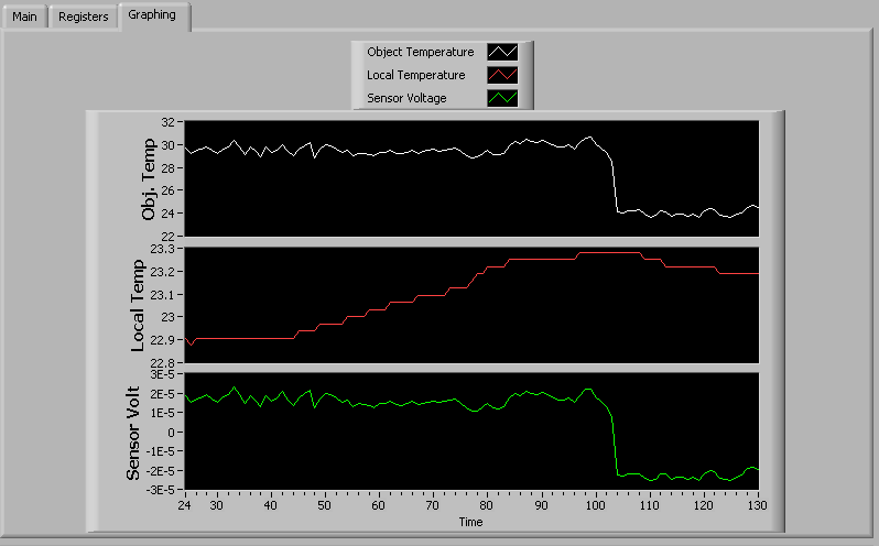

  • Jon,
    Here's a screenshot of a working TMP006EVM as an example. I simply had the EVM on my desk with the TMP006 sensor side pointing upward, and I placed my hand a couple inches away from it. Around t = 100s, I removed my hand. You can see that the object temperature is accurate within ±1°C, which meets typical data sheet performance.

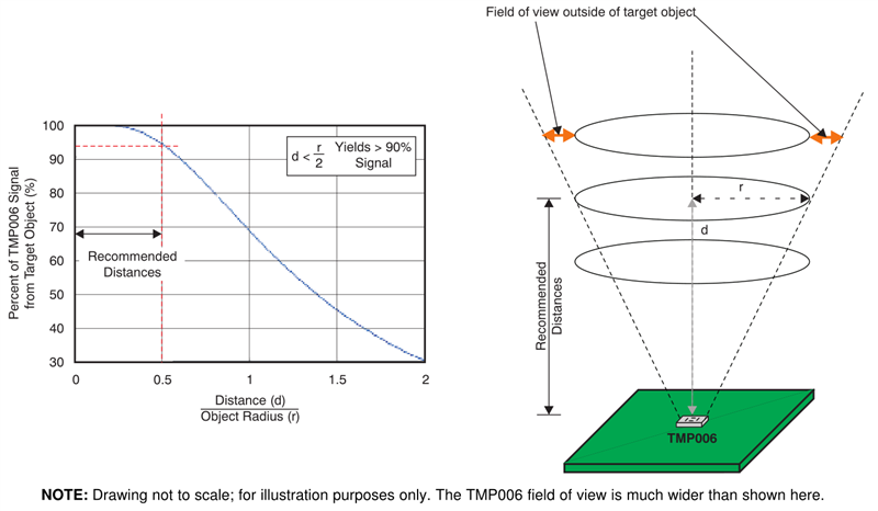

    Since the body uses skin as a cooling mechanism, skin temperature in general is significantly cooler than internal body temperature. For a more accurate representation of the internal body temp, I'd recommend pointing the TMP006EVM into the ear or mouth. The ear would be the better of the two since your breath will cause local airflow and temperature transients which can degrade accuracy.
    As for the recommended distance, as long as the target object dominates the TMP006's field of view then you should be fine. Formally, our TMP006 User's Guide states that the optimal distance to the target object is (0.5 * radius of target object) or less.

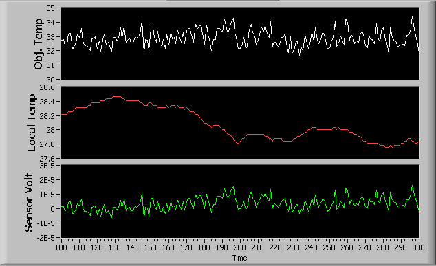

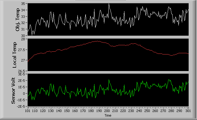

    I ran a series of tests tonight when I got home.  I noticed the following.  First, it took about 5 minutes for the results to calm down on any surface.  Once they results calmed down things like my hand, ear, desktop and cardboard kept a reasonable measurement.  However my forehead  or keyboard never settled down.  I played with the sampling rates and faster sampling made the stable objects worse.  They produced about an 8 degree C fluctuation.  I have attached some of the graph screen shots below.

  • Jon,
    Increasing the conversion rate does increase the peak-to-peak noise of the TOBJ reading, but the fluctuations you're seeing are higher than expected. I just did a forehead measurement with the TMP006EVM for comparison and saw a fluctuation of about ±2.5°C. I noticed in the first measurement that the TMP006 local temp changed by about 1°C, which can have a significant impact in the object temperature reading, so I re-ran the test in a newer version of the EVM software which includes a local temperature transient correction option. After enabling the correction, the fluctuation was reduced to ±1°C.  You can download the same version of the software at ftp://ftp.ti.com/pub/linear_apps/TMP006/TMP006EVM%20Installer.zip and experiment with enabling the transient correction algorithm to see if it improves your results.
