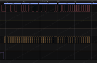

We set the QSPI input frequency to 80MHz and enabled DMA. Then, I observed the following clock signal waveform(read flash).
CMD Address   Data Data CMD Address   Data Data
6BH A23-A16 A15-A8 A7-A0 dummy 16bytes data 16bytes data 6BH A23-A16 A15-A8 A7-A0 dummy 16bytes data 16bytes data

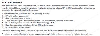

For every 32 bytes read, a command/address/dummy must be sent. Which is differenct with the discriptions of AWR294x Technical Reference Manual(action 5 is repeated until the byte count to be transferred reaches zero)
Is it correct? What does cause it? How to change our configuration to repeat action 5 until the byte count is zero?

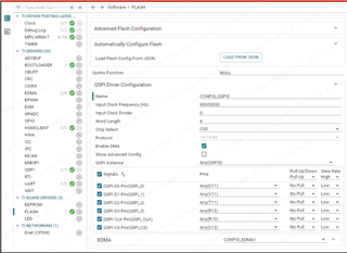

    Based on the "sbl_qspi" demo from the SDK(mcu_plus_sdk_awr294x_09_00_00_15),
    1. Enabe DMA for QSPI configuration.
    2. Add CONFIG_EDMA1 for EDMA_MSS_A configuration and the conguration parameters of CONFIG_EDMA1 is default value.
    3. flash configuration links to CONFIG_EDMA1

    We didn't modify the QSPI mode which is still memmap mode. The description is also from SFI Translator.
    We only enabled EDMA which configure QSPI as EDMA memmap mode.

    No. Such as, I want to read 1024 bytes. The expected sequence from the descriptions below is CMD + ADDR + DUMMY + 1024 bytes DATA.
    However the actual sequence is 1st(CMD + ADDR + DUMMY + 1 byte data)  + 2st(CMD + ADDR + DUMMY + 1 byte data) ... + 1024st(CMD + ADDR + DUMMY + 1 byte data))

    The data I've captured with my logic analyzer isn't quite accurate; we can only make a rough analysis.
    The new data in the attached is relatively better quality. Hope it is useful for you.
    7713.logic_log.rar
    In the first part of the diagram below, only SI (IO0) has data, so this section is CMD(1bytes) + ADDR(3bytes)+ dummy(1bytes).
    in the second part, IO0~IO3 have data all, so this section is data segment.
    Wu Bin

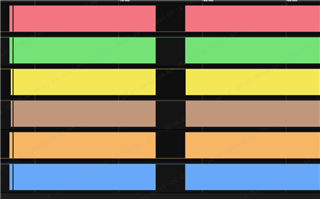

  • Hello Wu bin,
    When I am analyzing your logs:
    That is not exactly just 16 - 16 bytes right? It is a lot more bytes, so I am confused ow you are saying that between 2 commands there are 16-16 bytes each.
    We are only considering the command valid when the io1 , io2 and io3 all are high outputs(high impedance) and only when the command on line io0 is 6B
    So we see a lot of data getting transferred from your plot.
