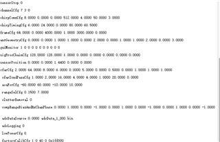

My customer run the mmw demo in sdk5.4, change to use below cfg, it reports "CFAR DPU config return error:-2801 " after sending sensorstart cmd.
Would u pls help check below cfg and let me know the problem? thanks.

our test runs the mmw demo in sdk5.4, We have the following questions:

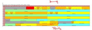

1.the CFAR Cfg parameter: as show above, the CFAR_GUARD is 8 , and the CFAR_AVG_RIGHT and the CFAR_AVG_LEFT are 64 both. And (CFAR_GUARD + CFAR_AVG_RIGHT) * 2 = 144 < 256, where, 256 is the number of range dimension samples, but it reports "CFAR DPU config return error:-2801. What if we want to increase the length of CFAR_GUARD?
2.the compression enable: Run default MMWAVE_L_SDK_05_04_00_01\examples\mmw_demo and MMWAVE_L_SDK_05_04_00_01\examples\mmw_demo\mmwave_demo\profiles on 6432EVM The default configuration in wrL64xx-evm is parking_5m.cfg, and there is no point cloud target output.
But when the configuration compressionCfg is disabled, some point clouds can be obtained with the following results
1. Due to hardware limitations, CFAR guard length must be less than 8. The register that holds this information is a 3-bit register. The image below comes from the HWA user guide.

As shown above, why an error occurs when the NumOfChirpsInBurst parameter is changed to 128 after enabling it. Lengthening the BurstPeriodicity still results in this error.
Error: mmWave Config failed [Error code: -3110 Subsystem: 0]

If you still receive the error -3110 even after increasing the burstPeriodicity then you may have actually set the burstPeriodicity higher than the accepted limits. If you change the burstPeriodicty to 8000 us then you can avoid this error but you will still face another issue due to memory size. With the configured number of samples/chirps/bursts there is insufficient memory required to allocate the detection matrix.
