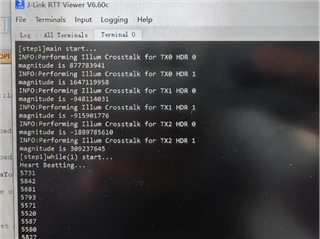

    2.Apply this->measureIllumCrosstalkSet(true); When the function is calibrated for illumination crosstalk, what does the magnitude variable mean and why the value I get is very strange, as shown in Figure 5. (You can only focus on TX0 data, only TX0 is used)

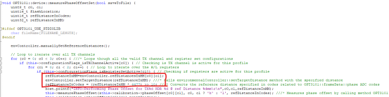

    1.envController.setTargetDistance(refDistanceInMM); This function is an empty function, can I manually move the white object to the distance I need (between 16000 and 24000 amplitude), and offset the large current and the small current separately. measurePhaseOffsetSet(true); Under this function, when c1=0 and c1=1, will opt3101 automatically switch the size current? Can I distinguish the two cases manually? When c1=0, it is a small current and 150mm aluminum plate is used for calibration? When c1=1, it is a high current and is calibrated with a white reflector at 150mm. (can meet the amplitude between 16000 and 24000 conditions)

      You will have 4 currents for the calibration. You will manually set each current, and use white or black backgrounds. Adjust the distance until you achieve the amplitude code between 16000 and 24000. I try for 20000 for best accuracy. Enter the information for all 4 currents and move to the calibration procedure. When asked place the background at the predetermined distance for the actual clibration. See below.
    In HDR mode you will have 4 currents. In HDR mode, the current can switch between 2 current settings on one TX channel, and with super-HDR, TX1 can be used to add 2 more current settings.
    The currents are set in the Configurator tool based on the design of your system. Then output the cpp by selecting the create configuration file in the lower right corner. Replace the existing "OPT3101_configuration.cpp" with the new file.
    You need to determine the correct distances for each current. The documentation recommends doing phase offset calibration at a target distance where the amplitude is between 16000-24000. The preset values in the SDK are arbitrary and definitely don’t follow this rule. The values are set like below in OPT3101Coefficients.cpp.

    The indexing on refDistancesInMM is [Tx channel] and [current setting, 0 being H and 1 being L]. In order for them to find the proper distances to set for each current and tx setting, you will need to change your configuration to do just one current, flash that, and see at what distance you can get 16000-24000 codes for that particular current. At higher currents, that distance will be pretty far with a white background, so you can use darker backgrounds in order to get lower amplitude settings, but they’ll need to remember what current settings used what color background when you do the calibration.
     Once you know these distances, you can enter that into OPT3101Coefficients.cpp and then use super-HDR configuration and perform the calibration.

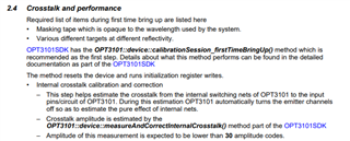

    In calibrationSession_firstTimeBringUp, the calibration file requires an amplitude of less than 30 to be measured, but based on the printed information from this function, there is no information about the amplitude

      The first calibration is internal and helps to cancel out electrical and optical crosstalk. By covering the photodiode with black out material, like black tape or using an actual black out tape, it is possible to measure the noise that is left over after the photodiode is cut off. The system corrects for electrical crosstalk and optical cross talk. When the corrections have been completed and applied, read the amplitude level. It should be less than 30 LSB codes. This is a good level to start with because it indicates that you have low noise in the system. If you still have more than 30 LSB codes of amplitude, then you need to look at your system. It may indicate a problem. Read out the amplitude register to see this value. The EVM GUI provides this value to you.
