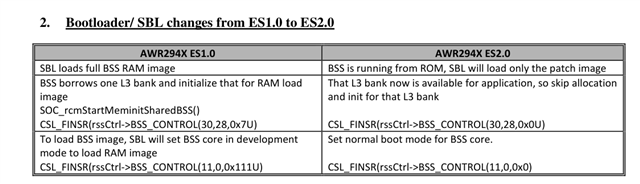

    I debugged the CSI2 mode by running it on the AWR 2844 ES1.0.
    but when zhe AWR2944 ES1.0 to ES2.0 changes,zhe CSI2 mode cannot receive.
    There are no changes related to CSI2 in the modification information from ES1.0 to ES2.0.
   May I ask if there is any good solution?

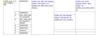

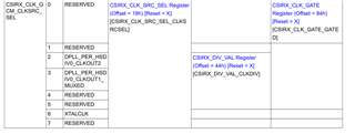

      Excuse me, do you know what clock and frequency CSI2 uses when configuring ES1.0?
    guilin.shi
  • Hello Shi guillin,
    I am not aware of the default value, whenever I use I always ensure to set the values of this myself in the application as that is a better practice of coding any device.
    On your Es 1.0 based on the clk_src_sel value you can tell which is the clock source, in your case If I remember was 0x0  itself, so based on the clock source you can find out.

      What is the clock and frequency used by CSI2 if CSIRX-CLK-SRC-SEL and CSIRX-DIV_VAL are configured to 0?
      In the ES1.0 program, it is configured as 0.
    I have now configured PLL_PER_HSDIVIDER-CLKOUT 0~3, CSIRX-CLK-SRC-SEL, and CSIRX-DIV_VAL to be consistent with ES1.0, but the CSI2 module still cannot be initialized.
      Do you have any suggestions?

    In the ES 1.0 can you try to set another clock source instead of default?
    It shows reserved if you see:
    When I checked with my team also they told that it should never be used in default as that has not been validated.
    Can you try ES 1.0 with a proper clock source and see if it works?

    I tried to configure CSIRX-CLK-SRC-SEL and CSIRX-DIV_VAL in ES1.0, and configuring 0 resulted in the same effect as 1.
    However, the CSI2 module of the ES2.0 chip with the same configuration still cannot function properly.
    I am using the same program. (Because sdk mmwave_mcuplus_sdk_04:04_1-02 can run on chips of ES1.0 and ES2.0)

  • Helo Shi guilin,
    You have mentioned that you select one, but according  to your program, the value for the CLK_SRC_SEL is  0x00000222 in both cases.
    Have you made this change purposefully?
    Only difference I see in this code is:
    Also when you say same code you are running in ES 1.0 vs ES 2.0, are you running the same application binary? Also does this application does it have the bss firmware, because es 1.0 and es 20 should have different firmware.
    Unless you are not using the bss in the application
    Saswat Kuamr
  • Hello Saswat,
    I deliberately set this CLK_SRC_SEL to 2 because DPLL_PER_HSDIV0_CLKCOU2 was originally planned to be used for the clock of CSI2 in the clock tree
    What I mean by running the same program is the following operation:
    1.Burn three files with a script(sbl_qspi.release.tiimage   sbl_uart_uniflash.release.tiimage awr2944_mmw_ti_demoDDM.appimage )
    2.Debugging and Running My App Program with CCS
    I don't know if BSS is used. I don't know if BSS has any impact on the CSI2 module

  • Hello Shi guilin,
    Let's try to change the approach.
    Can you take your old SBL and then make the below changes and try it on the ES 2.0 and then try the application?:
    Saswat Kumar
  • Hello Saswat,
      Sure, which part of the code do I need to modify for the first modification? ( SBL Loads full BSS RAM image ->   BSS is running from ROM, SBL will load only the patch image)
      Can you tell me which part of the code needs to be modified for the other two modifications? I'm afraid there might be problems caused by my code modifications。
    guilin.shi
  • Hello Shi guilin,
    1) The first part is that the app image that is created in the SDK should use the firmware from the DFP present in 4.4.1.2.
    2) and 3) the functions are already mentioned, only in those functions you have to modify.
    You can try it if theres any issue let me know

  • Hello Saswat,
      Using my old SBL program and modifying ES2.0, the CSI2 module can be used.
      If there are any results from your modifications based on 4.4.1.2 SDK, please update me.
    I can currently use the CSI2 module using the above method.
