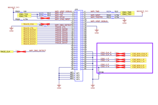

    Are you using the EVM, or your custom board? If it is the EVM, to enable CSI2 there are hardware modifications that need to be done:
    By default, there is no CSI2 connection on the EVM you will have to populate those as it is not connected.
    Can you check your hardware properly and the EVM as well. As far as I am aware there is nothing changed with the CSI2 IP from ES 1.0 to ES 2.0.

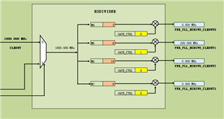

  • Hello Shi guilin,
    And have you seen this across multiple samples or a single sample?
    Also any clock changes you have done while migrating?
    Saswat Kumar
  • Hello Saswat,
    This issue was seen on all samples.(update to AWR2944 ES2.0)
    I haven't changed the clock, I just upgraded the SDK.
    Our hardware circuits and software have not been changed. ES2.0 software can run on ES1.0 hardware. I am currently using the same program when debugging.
    guilin.shi

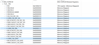

  • Hello Shi guillin,

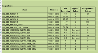

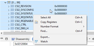

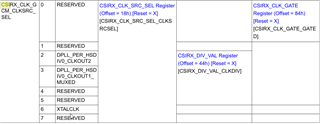

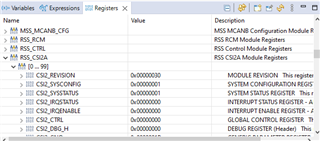

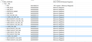

    Also, can you set a breakpoint after the pass condition in your code, and then take a register dump of CSI2 registers vs the ES 1.0 and the ES 2.0 case?
    Saswat Kumar
  • Hello Saswat,
    I dump of CSI2 registers vs the ES 1.0 and the ES 2.0.
    How can I send you the file? There is no attachment file included in this file.
    Can you give me your email so that I can send you the files via email.
    guilin.shi
    For the registers that are different can you send me ss, or CCS also has the capacity to copy the registers into plain text which can be copied to .txt which you can upload directly on e2e.
    Saswat Kuamr
  • Hello Saswat,
    The following is the dump value of the CSI2 register.

  • Hello Shi,
    I had requested for the register values that is present in the CCS in the top right corner under the registers tab itself:
    You can copy registers as well in notepad:
    In both failing and passing case share me the CSI2, MSS_TOPRCM, MSS_RCM and MSS_CTRL
    Direct dump like that it very hard to decode and time consuming as well, I would appreciate if you can give in a format like the registers I have attached below:
    RSS_CSI2A		RSS CSI2A Module Registers
    	[0 ... 99]
    		CSI2_REVISION	0x00000030	MODULE REVISION   This register contains the IP revision code in binary coded   digital. For example we have: 0x01 = revision 0.1 and 0x21   = revision 2.1    [Memory Mapped]
    		CSI2_SYSCONFIG	0x00000001	SYSTEM CONFIGURATION REGISTER   This register is the OCP-socket system configuration   register.    [Memory Mapped]
    		CSI2_SYSSTATUS	0x00000001	SYSTEM STATUS REGISTER   This register provides status information about the module   excluding the interrupt status register.    [Memory Mapped]
    		CSI2_IRQSTATUS	0x00000000	INTERRUPT STATUS REGISTER - All contexts   This register associates one bit for each context in order   to determine which context has generated the interrupt. The   context shall be enabled for events to be generated on that   context.   If the  [Memory Mapped]
    		CSI2_IRQENABLE	0x00000000	INTERRUPT ENABLE REGISTER - All contexts   This register associates one bit for each context in order   to enable/disable each context individually.    [Memory Mapped]
    		CSI2_CTRL	0x00000000	GLOBAL CONTROL REGISTER   This register controls the CSI2 RECEIVER module. This   register shall not be modified dynamically (except IF_EN bit   field).    [Memory Mapped]
    		CSI2_DBG_H	0x00000000	DEBUG REGISTER (Header)   This register provides a way to debug the CSI2 RECEIVER   module with no image sensor connected to the module. The   debug mode is enabled by CSI2_CTRL.DBG_EN. Only full 32-bit   values shall be written. The register is  [Memory Mapped]
    		CSI2_GNQ	0x0000001B	GENERIC PARAMETER REGISTER   This register provide a way to read the generic parameters   used in the design.    [Memory Mapped]
    		CSI2_COMPLEXIO_CFG2	0x00000000	COMPLEX IO CONFIGURATION REGISTER for the complex IO #2   This register contains the lane configuration for the order   and position of the lanes (clock and data) and the polarity   order for the control of the PHY differential signals in   addit [Memory Mapped]
    		CSI2_COMPLEXIO_CFG1	0x00000000	COMPLEXIO CONFIGURATION REGISTER for the complex IO #1   This register contains the lane configuration for the order   and position of the lanes (clock and data) and the polarity   order for the control of the PHY differential signals in   additi [Memory Mapped]
    		CSI2_COMPLEXIO1_IRQSTATUS	0x00000000	INTERRUPT STATUS REGISTER - All errors from complex IO #1    [Memory Mapped]
    		CSI2_COMPLEXIO2_IRQSTATUS	0x00000000	INTERRUPT STATUS REGISTER - All errors from complex IO #2    [Memory Mapped]
    		CSI2_SHORT_PACKET	0x00000000	SHORT PACKET INFORMATION -   This register sets the 24-bit DATA_ID + Short Packet Data   Field when the data type is between 0x8 and x0F    [Memory Mapped]
    		CSI2_COMPLEXIO1_IRQENABLE	0x00000000	INTERRUPT ENABLE REGISTER - All errors from complex IO #1    [Memory Mapped]
    		CSI2_COMPLEXIO2_IRQENABLE	0x00000000	INTERRUPT ENABLE REGISTER - All errors from complex IO #2    [Memory Mapped]
    		CSI2_DBG_P	0x00000000	DEBUG REGISTER (Payload)   This register provides a way to debug the CSI2 RECEIVER   module with no image sensor connected to the module. The   debug mode is enabled by CSI2_CTRL.DBG_EN. Only full 32-bit   values shall be written. The register is [Memory Mapped]
    		CSI2_TIMING	0x7FFF7FFF	TIMING REGISTER   This register controls the CSI2 RECEIVER module. This   register shall not be modified while CSI2_CTRL.IF_EN is set   to '1'.   It is used to indicate the number of L3 cycles for the Stop   State monitoring.    [Memory Mapped]
    		CSI2_CTX0_CTRL1	0x00010008	CONTROL REGISTER - Context   This register controls the Context. This register is   shadowed: modifications are taken into account after the   next FSC sync code.    [Memory Mapped]
    		CSI2_CTX0_CTRL2	0x00000000	CONTROL REGISTER - Context   This register controls the Context. This register is   shadowed: modifications are taken into account after the   next FSC sync code (except for VIRTUAL_ID and FORMAT   fields). The change of VIRTUIAL_ID and FORMAT ha [Memory Mapped]
    		CSI2_CTX0_DAT_OFST	0x00000000	DATA MEM ADDRESS OFFSET REGISTER - Context   This register sets the offset which is applied on the   destination address after each line is written to memory.   This register applies for both CSI2_CTX_DAT_PING_ADDR and   CSI2_CTX_DAT_PONG_ADDR.   [Memory Mapped]
    		CSI2_CTX0_DAT_PING_ADDR	0x00000000	DATA MEM PING ADDRESS REGISTER - Context   This register sets the 32-bit memory address where the pixel   data are stored. The destination is double buffered: this   register sets the PING address. Double buffering is enabled   when the addresses [Memory Mapped]
    		CSI2_CTX0_DAT_PONG_ADDR	0x00000000	DATA MEM PONG ADDRESS REGISTER - Context   This register sets the 32-bit memory address where the pixel   data are stored. The destination is double buffered: this   register sets the PONG address. Double buffering is enabled   when the addresses [Memory Mapped]
    		CSI2_CTX0_IRQENABLE	0x00000000	INTERRUPT ENABLE REGISTER - Context   This register regroups all the events related to Context.    [Memory Mapped]
    		CSI2_CTX0_IRQSTATUS	0x00000000	INTERRUPT STATUS REGISTER - Context   This register regroups all the events related to Context.    [Memory Mapped]
    		CSI2_CTX0_CTRL3	0x00000000	CONTROL REGISTER - Context   This register controls the Context. This register is   shadowed: modifications are taken into account after the   next FSC sync code.    [Memory Mapped]
    		CSI2_CTX1_CTRL1	0x00010008	CONTROL REGISTER - Context   This register controls the Context. This register is   shadowed: modifications are taken into account after the   next FSC sync code.    [Memory Mapped]
    		CSI2_CTX1_CTRL2	0x00000000	CONTROL REGISTER - Context   This register controls the Context. This register is   shadowed: modifications are taken into account after the   next FSC sync code (except for VIRTUAL_ID and FORMAT   fields). The change of VIRTUIAL_ID and FORMAT ha [Memory Mapped]
    		CSI2_CTX1_DAT_OFST	0x00000000	DATA MEM ADDRESS OFFSET REGISTER - Context   This register sets the offset which is applied on the   destination address after each line is written to memory.   This register applies for both CSI2_CTX_DAT_PING_ADDR and   CSI2_CTX_DAT_PONG_ADDR.   [Memory Mapped]
    		CSI2_CTX1_DAT_PING_ADDR	0x00000000	DATA MEM PING ADDRESS REGISTER - Context   This register sets the 32-bit memory address where the pixel   data are stored. The destination is double buffered: this   register sets the PING address. Double buffering is enabled   when the addresses [Memory Mapped]
    		CSI2_CTX1_DAT_PONG_ADDR	0x00000000	DATA MEM PONG ADDRESS REGISTER - Context   This register sets the 32-bit memory address where the pixel   data are stored. The destination is double buffered: this   register sets the PONG address. Double buffering is enabled   when the addresses [Memory Mapped]
    		CSI2_CTX1_IRQENABLE	0x00000000	INTERRUPT ENABLE REGISTER - Context   This register regroups all the events related to Context.    [Memory Mapped]
    		CSI2_CTX1_IRQSTATUS	0x00000000	INTERRUPT STATUS REGISTER - Context   This register regroups all the events related to Context.    [Memory Mapped]
    		CSI2_CTX1_CTRL3	0x00000000	CONTROL REGISTER - Context   This register controls the Context. This register is   shadowed: modifications are taken into account after the   next FSC sync code.    [Memory Mapped]
    		CSI2_CTX2_CTRL1	0x00010008	CONTROL REGISTER - Context   This register controls the Context. This register is   shadowed: modifications are taken into account after the   next FSC sync code.    [Memory Mapped]
    		CSI2_CTX2_CTRL2	0x00000000	CONTROL REGISTER - Context   This register controls the Context. This register is   shadowed: modifications are taken into account after the   next FSC sync code (except for VIRTUAL_ID and FORMAT   fields). The change of VIRTUIAL_ID and FORMAT ha [Memory Mapped]
    		CSI2_CTX2_DAT_OFST	0x00000000	DATA MEM ADDRESS OFFSET REGISTER - Context   This register sets the offset which is applied on the   destination address after each line is written to memory.   This register applies for both CSI2_CTX_DAT_PING_ADDR and   CSI2_CTX_DAT_PONG_ADDR.   [Memory Mapped]
    		CSI2_CTX2_DAT_PING_ADDR	0x00000000	DATA MEM PING ADDRESS REGISTER - Context   This register sets the 32-bit memory address where the pixel   data are stored. The destination is double buffered: this   register sets the PING address. Double buffering is enabled   when the addresses [Memory Mapped]
    		CSI2_CTX2_DAT_PONG_ADDR	0x00000000	DATA MEM PONG ADDRESS REGISTER - Context   This register sets the 32-bit memory address where the pixel   data are stored. The destination is double buffered: this   register sets the PONG address. Double buffering is enabled   when the addresses [Memory Mapped]
    		CSI2_CTX2_IRQENABLE	0x00000000	INTERRUPT ENABLE REGISTER - Context   This register regroups all the events related to Context.    [Memory Mapped]
    		CSI2_CTX2_IRQSTATUS	0x00000000	INTERRUPT STATUS REGISTER - Context   This register regroups all the events related to Context.    [Memory Mapped]
    		CSI2_CTX2_CTRL3	0x00000000	CONTROL REGISTER - Context   This register controls the Context. This register is   shadowed: modifications are taken into account after the   next FSC sync code.    [Memory Mapped]
    		CSI2_CTX3_CTRL1	0x00010008	CONTROL REGISTER - Context   This register controls the Context. This register is   shadowed: modifications are taken into account after the   next FSC sync code.    [Memory Mapped]
    		CSI2_CTX3_CTRL2	0x00000000	CONTROL REGISTER - Context   This register controls the Context. This register is   shadowed: modifications are taken into account after the   next FSC sync code (except for VIRTUAL_ID and FORMAT   fields). The change of VIRTUIAL_ID and FORMAT ha [Memory Mapped]
    		CSI2_CTX3_DAT_OFST	0x00000000	DATA MEM ADDRESS OFFSET REGISTER - Context   This register sets the offset which is applied on the   destination address after each line is written to memory.   This register applies for both CSI2_CTX_DAT_PING_ADDR and   CSI2_CTX_DAT_PONG_ADDR.   [Memory Mapped]
    		CSI2_CTX3_DAT_PING_ADDR	0x00000000	DATA MEM PING ADDRESS REGISTER - Context   This register sets the 32-bit memory address where the pixel   data are stored. The destination is double buffered: this   register sets the PING address. Double buffering is enabled   when the addresses [Memory Mapped]
    		CSI2_CTX3_DAT_PONG_ADDR	0x00000000	DATA MEM PONG ADDRESS REGISTER - Context   This register sets the 32-bit memory address where the pixel   data are stored. The destination is double buffered: this   register sets the PONG address. Double buffering is enabled   when the addresses [Memory Mapped]
    		CSI2_CTX3_IRQENABLE	0x00000000	INTERRUPT ENABLE REGISTER - Context   This register regroups all the events related to Context.    [Memory Mapped]
    		CSI2_CTX3_IRQSTATUS	0x00000000	INTERRUPT STATUS REGISTER - Context   This register regroups all the events related to Context.    [Memory Mapped]
    		CSI2_CTX3_CTRL3	0x00000000	CONTROL REGISTER - Context   This register controls the Context. This register is   shadowed: modifications are taken into account after the   next FSC sync code.    [Memory Mapped]
    		CSI2_CTX4_CTRL1	0x00010008	CONTROL REGISTER - Context   This register controls the Context. This register is   shadowed: modifications are taken into account after the   next FSC sync code.    [Memory Mapped]
    		CSI2_CTX4_CTRL2	0x00000000	CONTROL REGISTER - Context   This register controls the Context. This register is   shadowed: modifications are taken into account after the   next FSC sync code (except for VIRTUAL_ID and FORMAT   fields). The change of VIRTUIAL_ID and FORMAT ha [Memory Mapped]
    		CSI2_CTX4_DAT_OFST	0x00000000	DATA MEM ADDRESS OFFSET REGISTER - Context   This register sets the offset which is applied on the   destination address after each line is written to memory.   This register applies for both CSI2_CTX_DAT_PING_ADDR and   CSI2_CTX_DAT_PONG_ADDR.   [Memory Mapped]
    		CSI2_CTX4_DAT_PING_ADDR	0x00000000	DATA MEM PING ADDRESS REGISTER - Context   This register sets the 32-bit memory address where the pixel   data are stored. The destination is double buffered: this   register sets the PING address. Double buffering is enabled   when the addresses [Memory Mapped]
    		CSI2_CTX4_DAT_PONG_ADDR	0x00000000	DATA MEM PONG ADDRESS REGISTER - Context   This register sets the 32-bit memory address where the pixel   data are stored. The destination is double buffered: this   register sets the PONG address. Double buffering is enabled   when the addresses [Memory Mapped]
    		CSI2_CTX4_IRQENABLE	0x00000000	INTERRUPT ENABLE REGISTER - Context   This register regroups all the events related to Context.    [Memory Mapped]
    		CSI2_CTX4_IRQSTATUS	0x00000000	INTERRUPT STATUS REGISTER - Context   This register regroups all the events related to Context.    [Memory Mapped]
    		CSI2_CTX4_CTRL3	0x00000000	CONTROL REGISTER - Context   This register controls the Context. This register is   shadowed: modifications are taken into account after the   next FSC sync code.    [Memory Mapped]
    		CSI2_CTX5_CTRL1	0x00010008	CONTROL REGISTER - Context   This register controls the Context. This register is   shadowed: modifications are taken into account after the   next FSC sync code.    [Memory Mapped]
    		CSI2_CTX5_CTRL2	0x00000000	CONTROL REGISTER - Context   This register controls the Context. This register is   shadowed: modifications are taken into account after the   next FSC sync code (except for VIRTUAL_ID and FORMAT   fields). The change of VIRTUIAL_ID and FORMAT ha [Memory Mapped]
    		CSI2_CTX5_DAT_OFST	0x00000000	DATA MEM ADDRESS OFFSET REGISTER - Context   This register sets the offset which is applied on the   destination address after each line is written to memory.   This register applies for both CSI2_CTX_DAT_PING_ADDR and   CSI2_CTX_DAT_PONG_ADDR.   [Memory Mapped]
    		CSI2_CTX5_DAT_PING_ADDR	0x00000000	DATA MEM PING ADDRESS REGISTER - Context   This register sets the 32-bit memory address where the pixel   data are stored. The destination is double buffered: this   register sets the PING address. Double buffering is enabled   when the addresses [Memory Mapped]
    		CSI2_CTX5_DAT_PONG_ADDR	0x00000000	DATA MEM PONG ADDRESS REGISTER - Context   This register sets the 32-bit memory address where the pixel   data are stored. The destination is double buffered: this   register sets the PONG address. Double buffering is enabled   when the addresses [Memory Mapped]
    		CSI2_CTX5_IRQENABLE	0x00000000	INTERRUPT ENABLE REGISTER - Context   This register regroups all the events related to Context.    [Memory Mapped]
    		CSI2_CTX5_IRQSTATUS	0x00000000	INTERRUPT STATUS REGISTER - Context   This register regroups all the events related to Context.    [Memory Mapped]
    		CSI2_CTX5_CTRL3	0x00000000	CONTROL REGISTER - Context   This register controls the Context. This register is   shadowed: modifications are taken into account after the   next FSC sync code.    [Memory Mapped]
    		CSI2_CTX6_CTRL1	0x00010008	CONTROL REGISTER - Context   This register controls the Context. This register is   shadowed: modifications are taken into account after the   next FSC sync code.    [Memory Mapped]
    		CSI2_CTX6_CTRL2	0x00000000	CONTROL REGISTER - Context   This register controls the Context. This register is   shadowed: modifications are taken into account after the   next FSC sync code (except for VIRTUAL_ID and FORMAT   fields). The change of VIRTUIAL_ID and FORMAT ha [Memory Mapped]
    		CSI2_CTX6_DAT_OFST	0x00000000	DATA MEM ADDRESS OFFSET REGISTER - Context   This register sets the offset which is applied on the   destination address after each line is written to memory.   This register applies for both CSI2_CTX_DAT_PING_ADDR and   CSI2_CTX_DAT_PONG_ADDR.   [Memory Mapped]
    		CSI2_CTX6_DAT_PING_ADDR	0x00000000	DATA MEM PING ADDRESS REGISTER - Context   This register sets the 32-bit memory address where the pixel   data are stored. The destination is double buffered: this   register sets the PING address. Double buffering is enabled   when the addresses [Memory Mapped]
    		CSI2_CTX6_DAT_PONG_ADDR	0x00000000	DATA MEM PONG ADDRESS REGISTER - Context   This register sets the 32-bit memory address where the pixel   data are stored. The destination is double buffered: this   register sets the PONG address. Double buffering is enabled   when the addresses [Memory Mapped]
    		CSI2_CTX6_IRQENABLE	0x00000000	INTERRUPT ENABLE REGISTER - Context   This register regroups all the events related to Context.    [Memory Mapped]
    		CSI2_CTX6_IRQSTATUS	0x00000000	INTERRUPT STATUS REGISTER - Context   This register regroups all the events related to Context.    [Memory Mapped]
    		CSI2_CTX6_CTRL3	0x00000000	CONTROL REGISTER - Context   This register controls the Context. This register is   shadowed: modifications are taken into account after the   next FSC sync code.    [Memory Mapped]
    		CSI2_CTX7_CTRL1	0x00010008	CONTROL REGISTER - Context   This register controls the Context. This register is   shadowed: modifications are taken into account after the   next FSC sync code.    [Memory Mapped]
    		CSI2_CTX7_CTRL2	0x00000000	CONTROL REGISTER - Context   This register controls the Context. This register is   shadowed: modifications are taken into account after the   next FSC sync code (except for VIRTUAL_ID and FORMAT   fields). The change of VIRTUIAL_ID and FORMAT ha [Memory Mapped]
    		CSI2_CTX7_DAT_OFST	0x00000000	DATA MEM ADDRESS OFFSET REGISTER - Context   This register sets the offset which is applied on the   destination address after each line is written to memory.   This register applies for both CSI2_CTX_DAT_PING_ADDR and   CSI2_CTX_DAT_PONG_ADDR.   [Memory Mapped]
    		CSI2_CTX7_DAT_PING_ADDR	0x00000000	DATA MEM PING ADDRESS REGISTER - Context   This register sets the 32-bit memory address where the pixel   data are stored. The destination is double buffered: this   register sets the PING address. Double buffering is enabled   when the addresses [Memory Mapped]
    		CSI2_CTX7_DAT_PONG_ADDR	0x00000000	DATA MEM PONG ADDRESS REGISTER - Context   This register sets the 32-bit memory address where the pixel   data are stored. The destination is double buffered: this   register sets the PONG address. Double buffering is enabled   when the addresses [Memory Mapped]
    		CSI2_CTX7_IRQENABLE	0x00000000	INTERRUPT ENABLE REGISTER - Context   This register regroups all the events related to Context.    [Memory Mapped]
    		CSI2_CTX7_IRQSTATUS	0x00000000	INTERRUPT STATUS REGISTER - Context   This register regroups all the events related to Context.    [Memory Mapped]
    		CSI2_CTX7_CTRL3	0x00000000	CONTROL REGISTER - Context   This register controls the Context. This register is   shadowed: modifications are taken into account after the   next FSC sync code.    [Memory Mapped]
    		CSI2_PHY_CFG_REG0	0x00000000	Memory Mapped
    		CSI2_PHY_CFG_REG1	0x00000000	Memory Mapped
    		CSI2_PHY_CFG_REG2	0x00000000	Memory Mapped
    		CSI2_PHY_CFG_REG3	0x00000000	Memory Mapped
    		CSI2_PHY_CFG_REG4	0x00000000	Memory Mapped
    		CSI2_PHY_CFG_REG5	0x00000000	Memory Mapped
    		CSI2_PHY_CFG_REG6	0x00000000	Memory Mapped
    		CSI2_CTX0_TRANSCODEH	0x00000000	Transcode configuration register: defines horizontal frame cropping [Memory Mapped]
    		CSI2_CTX0_TRANSCODEV	0x00000000	Transcode configuration register: defines vertical frame cropping [Memory Mapped]
    		CSI2_CTX1_TRANSCODEH	0x00000000	Transcode configuration register: defines horizontal frame cropping [Memory Mapped]
    		CSI2_CTX1_TRANSCODEV	0x00000000	Transcode configuration register: defines vertical frame cropping [Memory Mapped]
    		CSI2_CTX2_TRANSCODEH	0x00000000	Transcode configuration register: defines horizontal frame cropping [Memory Mapped]
    		CSI2_CTX2_TRANSCODEV	0x00000000	Transcode configuration register: defines vertical frame cropping [Memory Mapped]
    		CSI2_CTX3_TRANSCODEH	0x00000000	Transcode configuration register: defines horizontal frame cropping [Memory Mapped]
    		CSI2_CTX3_TRANSCODEV	0x00000000	Transcode configuration register: defines vertical frame cropping [Memory Mapped]
    		CSI2_CTX4_TRANSCODEH	0x00000000	Transcode configuration register: defines horizontal frame cropping [Memory Mapped]
    		CSI2_CTX4_TRANSCODEV	0x00000000	Transcode configuration register: defines vertical frame cropping [Memory Mapped]
    		CSI2_CTX5_TRANSCODEH	0x00000000	Transcode configuration register: defines horizontal frame cropping [Memory Mapped]
    		CSI2_CTX5_TRANSCODEV	0x00000000	Transcode configuration register: defines vertical frame cropping [Memory Mapped]
    	[100 ... 103]
    		CSI2_CTX6_TRANSCODEH	0x00000000	Transcode configuration register: defines horizontal frame cropping [Memory Mapped]
    		CSI2_CTX6_TRANSCODEV	0x00000000	Transcode configuration register: defines vertical frame cropping [Memory Mapped]
    		CSI2_CTX7_TRANSCODEH	0x00000000	Transcode configuration register: defines horizontal frame cropping [Memory Mapped]
    		CSI2_CTX7_TRANSCODEV	0x00000000	Transcode configuration register: defines vertical frame cropping [Memory Mapped]

    ES2.0
    [0 ... 99]
    CSI2_SYSCONFIG 0x00002001 SYSTEM CONFIGURATION REGISTER This register is the OCP-socket system configuration register. [Memory Mapped]
    CSI2_IRQENABLE 0x00000003 INTERRUPT ENABLE REGISTER - All contexts This register associates one bit for each context in order to enable/disable each context individually. [Memory Mapped]
    CSI2_CTRL 0x00002079 GLOBAL CONTROL REGISTER This register controls the CSI2 RECEIVER module. This register shall not be modified dynamically (except IF_EN bit field). [Memory Mapped]
    CSI2_COMPLEXIO_CFG1 0x4A000213 COMPLEXIO CONFIGURATION REGISTER for the complex IO #1 This register contains the lane configuration for the order and position of the lanes (clock and data) and the polarity order for the control of the PHY differential signals in additi [Memory Mapped]
    CSI2_COMPLEXIO1_IRQENABLE 0x00739CE7 INTERRUPT ENABLE REGISTER - All errors from complex IO #1 [Memory Mapped]
    CSI2_TIMING 0x7FFFFFFF TIMING REGISTER This register controls the CSI2 RECEIVER module. This register shall not be modified while CSI2_CTRL.IF_EN is set to '1'. It is used to indicate the number of L3 cycles for the Stop State monitoring. [Memory Mapped]
    CSI2_CTX0_CTRL1 0x0001000B CONTROL REGISTER - Context This register controls the Context. This register is shadowed: modifications are taken into account after the next FSC sync code. [Memory Mapped]
    CSI2_CTX0_CTRL2 0x0000002A CONTROL REGISTER - Context This register controls the Context. This register is shadowed: modifications are taken into account after the next FSC sync code (except for VIRTUAL_ID and FORMAT fields). The change of VIRTUIAL_ID and FORMAT ha [Memory Mapped]
    CSI2_CTX0_DAT_PING_ADDR 0x88235000 DATA MEM PING ADDRESS REGISTER - Context This register sets the 32-bit memory address where the pixel data are stored. The destination is double buffered: this register sets the PING address. Double buffering is enabled when the addresses [Memory Mapped]
    CSI2_CTX0_DAT_PONG_ADDR 0x88235000 DATA MEM PONG ADDRESS REGISTER - Context This register sets the 32-bit memory address where the pixel data are stored. The destination is double buffered: this register sets the PONG address. Double buffering is enabled when the addresses [Memory Mapped]
    CSI2_CTX0_IRQENABLE 0x0000008F INTERRUPT ENABLE REGISTER - Context This register regroups all the events related to Context. [Memory Mapped]
    CSI2_CTX0_CTRL3 0x00000001 CONTROL REGISTER - Context This register controls the Context. This register is shadowed: modifications are taken into account after the next FSC sync code. [Memory Mapped]
    CSI2_CTX1_CTRL1 0x0001000B CONTROL REGISTER - Context This register controls the Context. This register is shadowed: modifications are taken into account after the next FSC sync code. [Memory Mapped]
    CSI2_CTX1_CTRL2 0x0000082A CONTROL REGISTER - Context This register controls the Context. This register is shadowed: modifications are taken into account after the next FSC sync code (except for VIRTUAL_ID and FORMAT fields). The change of VIRTUIAL_ID and FORMAT ha [Memory Mapped]
    CSI2_CTX1_DAT_PING_ADDR 0xA4000000 DATA MEM PING ADDRESS REGISTER - Context This register sets the 32-bit memory address where the pixel data are stored. The destination is double buffered: this register sets the PING address. Double buffering is enabled when the addresses [Memory Mapped]
    CSI2_CTX1_DAT_PONG_ADDR 0xA4000000 DATA MEM PONG ADDRESS REGISTER - Context This register sets the 32-bit memory address where the pixel data are stored. The destination is double buffered: this register sets the PONG address. Double buffering is enabled when the addresses [Memory Mapped]
    CSI2_CTX1_IRQENABLE 0x0000008F INTERRUPT ENABLE REGISTER - Context This register regroups all the events related to Context. [Memory Mapped]
    CSI2_CTX1_CTRL3 0x00000001 CONTROL REGISTER - Context This register controls the Context. This register is shadowed: modifications are taken into account after the next FSC sync code. [Memory Mapped]
    Could you also provide the other registers I had asked for here:
    Saswat Kumar
    Why is there a change in the configuration of the phy registers:
    Saswat Kumar
  • Hello Saswat,
    Sorry, I only noticed the CSI2 register, the rest are below. Let me check configuration of the phy registers.
    ES1.0
    MSS_TOPRCM
    [0 ... 99]
    PID 0x61800214 PID register [Memory Mapped]
    HW_REG0 0x00000000 Memory Mapped
    HW_REG1 0x00000000 Memory Mapped
    PREVIOUS_NAME 0x00000000 Memory Mapped
    HW_REG3 0x00000000 Memory Mapped
    HSI_CLK_SRC_SEL 0x00000333 Memory Mapped
    CSIRX_CLK_SRC_SEL 0x00000000 Memory Mapped
    MCUCLKOUT_CLK_SRC_SEL 0x00000000 Memory Mapped
    PMICCLKOUT_CLK_SRC_SEL 0x00000000 Memory Mapped
    OBSCLKOUT_CLK_SRC_SEL 0x00000000 Memory Mapped
    TRCCLKOUT_CLK_SRC_SEL 0x00000000 Memory Mapped
    CSIRX_DIV_VAL 0x00000000 Memory Mapped
    MCUCLKOUT_DIV_VAL 0x00000000 Memory Mapped
    PMICCLKOUT_DIV_VAL 0x00000000 Memory Mapped
    OBSCLKOUT_DIV_VAL 0x00000000 Memory Mapped
    TRCCLKOUT_DIV_VAL 0x00000000 Memory Mapped
    CSIRX_CLK_GATE 0x00000000 Memory Mapped
    MCUCLKOUT_CLK_GATE 0x00000007 Memory Mapped
    PMICCLKOUT_CLK_GATE 0x00000007 Memory Mapped
    OBSCLKOUT_CLK_GATE 0x00000000 Memory Mapped
    TRCCLKOUT_CLK_GATE 0x00000000 Memory Mapped
    DSS_CLK_GATE 0x00000000 Memory Mapped
    HSI_CLK_STATUS 0x00000004 Memory Mapped
    CSIRX_CLK_STATUS 0x00000001 Memory Mapped
    MCUCLKOUT_CLK_STATUS 0x00000100 Memory Mapped
    PMICCLKOUT_CLK_STATUS 0x00000100 Memory Mapped
    OBSCLKOUT_CLK_STATUS 0x00000001 Memory Mapped
    TRCCLKOUT_CLK_STATUS 0x00000001 Memory Mapped
    WARM_RESET_CONFIG 0x00070707 Memory Mapped
    SYS_RST_CAUSE 0x00000009 Memory Mapped
    SYS_RST_CAUSE_CLR 0x00000000 Memory Mapped
    DSS_RST_CTRL 0x00000000 Memory Mapped
    RS232_BITINTERVAL 0x6C815D5B Memory Mapped
    LVDS_PAD_CTRL0 0x00000000 Memory Mapped
    LVDS_PAD_CTRL1 0x02000000 Memory Mapped
    DFT_DMLED_EXEC 0x00000000 Memory Mapped
    DFT_DMLED_STATUS 0x00000000 Memory Mapped
    LIMP_MODE_EN 0x00000000 Memory Mapped
    PMICCLKOUT_DCDC_CTRL 0x00000000 Memory Mapped
    PMICCLKOUT_DCDC_SLOPE 0x00000000 Memory Mapped
    RCOSC32K_CTRL 0x00000000 Memory Mapped
    ANA_HSI2DIGCLK_GATE 0x00000007 Memory Mapped
    PLL_CORE_PWRCTRL 0x00000030 Memory Mapped
    PLL_CORE_CLKCTRL 0x28135001 Memory Mapped
    PLL_CORE_TENABLE 0x00000000 Memory Mapped
    PLL_CORE_TENABLEDIV 0x00000000 Memory Mapped
    PLL_CORE_M2NDIV 0x00010013 Memory Mapped
    PLL_CORE_MN2DIV 0x000002EE Memory Mapped
    PLL_CORE_FRACDIV 0x06000000 Memory Mapped
    PLL_CORE_BWCTRL 0x00000000 Memory Mapped
    PLL_CORE_FRACCTRL 0x00000000 Memory Mapped
    PLL_CORE_STATUS 0xC0000E30 Memory Mapped
    PLL_CORE_HSDIVIDER 0x00010000 Memory Mapped
    PLL_CORE_HSDIVIDER_CLKOUT0 0x00000321 Memory Mapped
    PLL_CORE_HSDIVIDER_CLKOUT1 0x00000322 Memory Mapped
    PLL_CORE_HSDIVIDER_CLKOUT2 0x00000324 Memory Mapped
    PLL_CORE_HSDIVIDER_CLKOUT3 0x00000024 Memory Mapped
    MSS_CR5_CLK_SRC_SEL 0x00000222 Memory Mapped
    MSS_CR5_DIV_VAL 0x00000000 Memory Mapped
    SYS_CLK_DIV_VAL 0x00000111 Memory Mapped
    MSS_CR5_CLK_GATE 0x00000000 Memory Mapped
    SYS_CLK_GATE 0x00000000 Memory Mapped
    SYS_CLK_STATUS 0x00000100 Memory Mapped
    MSS_CR5_CLK_STATUS 0x00000004 Memory Mapped
    PLL_CORE_RSTCTRL 0x00000000 Memory Mapped
    PLL_CORE_HSDIVIDER_RSTCTRL 0x00000000 Memory Mapped
    RSS_CLK_SRC_SEL 0x00000333 Memory Mapped
    PLLC_CLK2_SRC_SEL 0x00000000 Memory Mapped
    PLLD_CLK1_SRC_SEL 0x00000000 Memory Mapped
    PLLD_CLK2_SRC_SEL 0x00000000 Memory Mapped
    PLLP_CLK1_SRC_SEL 0x00000000 Memory Mapped
    RSS_DIV_VAL 0x00000000 Memory Mapped
    RSS_CLK_GATE 0x00000000 Memory Mapped
    PLLC_CLK2_GATE 0x00000000 Memory Mapped
    PLLD_CLK1_GATE 0x00000000 Memory Mapped
    PLLD_CLK2_GATE 0x00000000 Memory Mapped
    PLLP_CLK1_GATE 0x00000000 Memory Mapped
    RSS_CLK_STATUS 0x00000008 Memory Mapped
    PLLC_CLK2_STATUS 0x00000001 Memory Mapped
    PLLD_CLK1_STATUS 0x00000001 Memory Mapped
    PLLD_CLK2_STATUS 0x00000001 Memory Mapped
    PLLP_CLK1_STATUS 0x00000001 Memory Mapped
    PLL_1P2_HSDIVIDER 0x00010000 Memory Mapped
    PLL_1P2_HSDIVIDER_CLKOUT0 0x00000002 Memory Mapped
    PLL_1P2_HSDIVIDER_CLKOUT1 0x00000004 Memory Mapped
    PLL_1P2_HSDIVIDER_CLKOUT2 0x00000004 Memory Mapped
    PLL_1P2_HSDIVIDER_CLKOUT3 0x00000305 Memory Mapped
    PLL_1P2_HSDIVIDER_RSTCTRL 0x00000000 Memory Mapped
    PLL_1P8_HSDIVIDER 0x00000000 Memory Mapped
    PLL_1P8_HSDIVIDER_CLKOUT0 0x00000024 Memory Mapped
    PLL_1P8_HSDIVIDER_CLKOUT1 0x00000024 Memory Mapped
    PLL_1P8_HSDIVIDER_CLKOUT2 0x00000024 Memory Mapped
    PLL_1P8_HSDIVIDER_CLKOUT3 0x00000024 Memory Mapped
    PLL_1P8_HSDIVIDER_RSTCTRL 0x00000000 Memory Mapped
    PLL_DSP_PWRCTRL 0x00000030 Memory Mapped
    PLL_DSP_CLKCTRL 0x28135001 Memory Mapped
    PLL_DSP_TENABLE 0x00000000 Memory Mapped
    PLL_DSP_TENABLEDIV 0x00000000 Memory Mapped
    PLL_DSP_M2NDIV 0x00010013 Memory Mapped
    PLL_DSP_MN2DIV 0x00000168 Memory Mapped

    ES2.0
    MSS_TOPRCM
    [0 ... 99]

    guilin.shi
  • Hello Saswat,
    I checked the code and found that this  the configuration of the phy register(CSI2_PHY_CFG_REG4) is not configured by me, it is set by the default of the chip.
    The code only sets registers 0~2.
    I found out during today's investigation that the problem lies in the files(xwr2xxx_radarss_metarprc.bin).
    I used ES1.0 demo appimage on ES2.0 HWA.CSI2 module is working properly.
    but I used ES2.0 demo appimage,CSI2 module not workong properly.
    But I don't know why, nor do I know how to modify it to make the CSI2 module work properly on the ES2.0 demo.
    guilin.shi
  • Hello Shi,
    Thanks for what you have shared but this is not the entire list:
    You have only sent 0-99 for each also.
    Also Please just update it into a es1reg.txt and es2reg.txt file like I have attached here:
    You can see below that I just dragged and dropped the sample.txt file, it will keep this entire conversation in one page then.
    Saswat Kumar
    Can you also tell me for es 2.0 which SBL you are using and es 1.0 which SBL you are using?
    How did you load Es 1.0 image on es2.0? which SBL in this case?
    Can you explain in a little more detail?
    Ideally it wouldn't be the firmware, it would be some register setting which would be different which could cause this to happen. That is the only reason I have asked you to share all those logs.
    Saswat Kumar
  • Hello Saswat,
    Here is the SDK version of SBL that I am using.(ES 1.0:mmwave_mcuplus_sdk_04_02_00_03 , ES 2.0 :mmwave_mcuplus_sdk_04_04_01_02)
    Please check if the TXT file can be received.
    [0 ... 99]
    [100 ... 164]
    	PLL_DSP_FRACDIV	0x03000000	Memory Mapped
    	PLL_DSP_BWCTRL	0x00000000	Memory Mapped
    	PLL_DSP_FRACCTRL	0x00000000	Memory Mapped
    	PLL_DSP_STATUS	0xC0000E38	Memory Mapped
    	PLL_DSP_HSDIVIDER	0x00010000	Memory Mapped
    	PLL_DSP_HSDIVIDER_CLKOUT0	0x00000004	Memory Mapped
    	PLL_DSP_HSDIVIDER_CLKOUT1	0x00000301	Memory Mapped
    	PLL_DSP_HSDIVIDER_CLKOUT2	0x00000302	Memory Mapped
    	PLL_DSP_HSDIVIDER_CLKOUT3	0x00000004	Memory Mapped
    	PLL_PER_PWRCTRL	0x00000030	Memory Mapped
    	PLL_PER_CLKCTRL	0x28135001	Memory Mapped
    	PLL_PER_TENABLE	0x00000000	Memory Mapped
    	PLL_PER_TENABLEDIV	0x00000000	Memory Mapped
    	PLL_PER_M2NDIV	0x00010013	Memory Mapped
    	PLL_PER_MN2DIV	0x00000384	Memory Mapped
    	PLL_PER_FRACDIV	0x08000000	Memory Mapped
    	PLL_PER_BWCTRL	0x00000000	Memory Mapped
    	PLL_PER_FRACCTRL	0x00000000	Memory Mapped
    	PLL_PER_STATUS	0xC0000E38	Memory Mapped
    	PLL_PER_HSDIVIDER	0x00010000	Memory Mapped
    	PLL_PER_HSDIVIDER_CLKOUT0	0x00000004	Memory Mapped
    	PLL_PER_HSDIVIDER_CLKOUT1	0x00000308	Memory Mapped
    	PLL_PER_HSDIVIDER_CLKOUT2	0x00000004	Memory Mapped
    	PLL_PER_HSDIVIDER_CLKOUT3	0x00000004	Memory Mapped
    	PLL_DSP_RSTCTRL	0x00000000	Memory Mapped
    	PLL_DSP_HSDIVIDER_RSTCTRL	0x00000000	Memory Mapped
    	PLL_PER_RSTCTRL	0x00000000	Memory Mapped
    	PLL_PER_HSDIVIDER_RSTCTRL	0x00000000	Memory Mapped
    	ANA_REG_CLK_CTRL_REG1_XO_SLICER	0x00000200	Memory Mapped
    	ANA_REG_CLK_CTRL_REG1_CLKTOP	0x00000007	Memory Mapped
    	ANA_REG_CLK_CTRL_REG2_CLKTOP	0x00000000	Memory Mapped
    	ANA_REG_CLK_CTRL_REG1_LDO_CLKTOP	0x00000001	Memory Mapped
    	ANA_REG_CLK_CTRL_REG2_LDO_CLKTOP	0x00400710	Memory Mapped
    	ANA_REG_CLK_STATUS_REG	0x00000000	Memory Mapped
    	ANA_REG_REFSYS_CTRL_REG_LOWV	0x022080D3	Memory Mapped
    	ANA_REG_REFSYS_TMUX_CTRL_LOWV	0x00000000	Memory Mapped
    	ANA_REG_REFSYS_SPARE_REG_LOWV	0x00000000	Memory Mapped
    	ANA_REG_WU_CTRL_REG_LOWV	0x6076825D	Memory Mapped
    	ANA_REG_WU_TMUX_CTRL_LOWV	0x00000000	Memory Mapped
    	ANA_REG_TW_CTRL_REG_LOWV	0x00000000	Memory Mapped
    	ANA_REG_TW_ANA_TMUX_CTRL_LOWV	0x00000000	Memory Mapped
    	ANA_REG_WU_MODE_REG_LOWV	0x00000004	Memory Mapped
    	ANA_REG_WU_STATUS_REG_LOWV	0x0000BC78	Memory Mapped
    	ANA_REG_WU_SPARE_OUT_LOWV	0x00000029	Memory Mapped
    	HW_SPARE_RW0	0x00000000	Memory Mapped
    	HW_SPARE_RW1	0x00000000	Memory Mapped
    	HW_SPARE_RW2	0x00000000	Memory Mapped
    	HW_SPARE_RW3	0x00000000	Memory Mapped
    	HW_SPARE_RO0	0x00000000	Memory Mapped
    	HW_SPARE_RO1	0x00000000	Memory Mapped
    	HW_SPARE_RO2	0x00000000	Memory Mapped
    	HW_SPARE_RO3	0x00000000	Memory Mapped
    	HW_SPARE_WPH	0x00000000	Memory Mapped
    	HW_SPARE_REC	0x00000000	Memory Mapped
    	LOCK0_KICK0	0x00000000	- KICK0 component  [Memory Mapped]
    	LOCK0_KICK1	0x00000000	- KICK1 component  [Memory Mapped]
    	intr_raw_status	0x00000002	Interrupt Raw Status/Set Register  [Memory Mapped]
    	intr_enabled_status_clear	0x00000000	Interrupt Enabled Status/Clear register  [Memory Mapped]
    	intr_enable	0x00000000	Interrupt Enable register  [Memory Mapped]
    	intr_enable_clear	0x00000000	Interrupt Enable Clear register  [Memory Mapped]
    	eoi	0x00000000	EOI register  [Memory Mapped]
    	fault_address	0x00000040	Fault Address register  [Memory Mapped]
    	fault_type_status	0x00000044	Fault Type Status register  [Memory Mapped]
    	fault_attr_status	0x00000000	Fault Attribute Status register  [Memory Mapped]
    	fault_clear	0x00000000	Fault Clear register  [Memory Mapped]
    [0 ... 99]
    	CSI2_COMPLEXIO_CFG2	0x20000000	COMPLEX IO CONFIGURATION REGISTER for the complex IO #2   This register contains the lane configuration for the order   and position of the lanes (clock and data) and the polarity   order for the control of the PHY differential signals in   addit [Memory Mapped]
    	CSI2_COMPLEXIO_CFG1	0x6A000213	COMPLEXIO CONFIGURATION REGISTER for the complex IO #1   This register contains the lane configuration for the order   and position of the lanes (clock and data) and the polarity   order for the control of the PHY differential signals in   additi [Memory Mapped]
    	CSI2_CTX0_CTRL1	0x00010003	CONTROL REGISTER - Context   This register controls the Context. This register is   shadowed: modifications are taken into account after the   next FSC sync code.    [Memory Mapped]
    	PLL_CORE_HSDIVIDER_CLKOUT0	0x00001001	Memory Mapped
    	PLL_CORE_HSDIVIDER_CLKOUT1	0x00000302	Memory Mapped
    	PLL_CORE_HSDIVIDER_CLKOUT2	0x00000301	Memory Mapped
    	PLL_CORE_HSDIVIDER_CLKOUT3	0x00000302	Memory Mapped

    Looks like from this register comparison:
    Your hsdiv 0,2,3 clockouts for per pll and some for DSP are also powered down.
    Can you check what you are using as the clock source for CSI2 and which divider and what value as well?
    Saswat Kumar
  • Hello Saswat,
    What I understand is that the clock source of CSI2 uses an external clock, which CSI2_RX_CLK_P and CSI2_RX_CLK_N pin.When I was debugging, the external devices were the same, so the clock should be consistent.

    ("Please select a valid source for this as well, and modify it accordingly in the SBL where it does the clock.")
    I am currently using an external clock.(which CSI2_RX_CLK_P and CSI2_RX_CLK_N pin)
    guilin.shi

  • Hello Saswat,
    I tried manually configuring registers when the program stopped before CSI_init.
    (CSIRX_CLK_SRC_SEL register  = 0x222,  CSIRX_DIV_VAL register = 0x111)
    I have tried to modify the different registers in ES1.0 and ES2.0, but some registers do not allow manual modification.(likePLL_CORE_HSDIVIDER_CLKOUT0)
    I don't know if this modification method is not allowed, but in the end, CSI_init still didn't succeed
    guilin.shi

    I can see through CCS that the value of the register has been modified to the value I set. But CSI2 init still cannot succeed.
    guilin.shi
    Also can you check once in the HSDIV_CLKOUT register once to see if the divider is ungated, it should be mostly. Just for cross checking
    Saswat Kumar
  • Hello Saswat,
    I checked the register values, but I don't know what they mean. Does it meet my requirements.
    Here is what I saved

    guilin.shi
  • Hello Shi guilin,
    Here your clk_src_sel is 0x222
    Which means from this diagram
    So for whichever clock you are selecting as source for the CSIRX CLK SRC SEL:
    YOu are selecting PER_HSDIV0_CLKOUT2
    In the logs you have sent:
    PLL_PER_HSDIVIDER_CLKOUT2 0x00001004 Memory Mapped
    In this the 12th bit: PLL_PER_HSDIVIDER_CLKOUT2_PWDN is 1 which means CLKOUT2 divider is powered down

       I want to configure the CSI2 clock through a clock tree file.
      Because PER_PLL_HSDIV0_CLKOUT1 is currently in use, I understand that I only need to configure the values of M6 and GATE_CTRL for clock PER_PLL_HSDIV0_CLKOUT2.Set up through the following code.
    But this value has always been 1(PLL_PER_HSDIVIDER_CLKOUT2_PWDN is 1).
        p1 = (unsigned int*)0x02140870u;
        *p1 = 0x108u;
    Can you provide me with a code to configure the CSI2 clock of ES2.0 to be consistent with the CSI2 clock of ES1.0? in function
