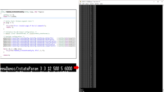

  I use the 3D People Tracking example code in radar toolbox v2.0.0.6 and execute CLI_write() command to print out the log. But the mmWave Sensor will be crash. Can you please help to check this issue?
mmWaveSDK:  03_06_02_00-LTS
radar toolbox: v2.0.0.6
3D People Tracking example code: radar_toolbox_2_00_00_06\source\ti\examples\People_Tracking\3D_People_Tracking
mss_main.c

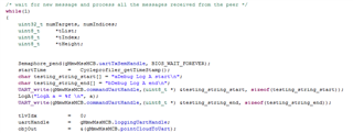

void MmwDemo_uartTxTask(UArg arg0, UArg arg1){
     uint32_t a = 1;
     while (1)
           Semaphore_pend(gMmwMssMCB.uartTxSemHandle, BIOS_WAIT_FOREVER);

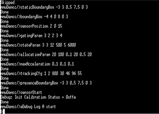

           CLI_write("DebugMsg: CLI mmWave TimeStamp a = %u \n", a);
The radar will happen crash after print one line log.
DebugMsg: CLI mmWave TimeStamp a=1                   ==> The sensor crash.
Thanks.
Thanks.

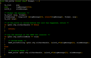

      I don't think it's the root cause. In this example, there is a "Semaphore_pend" to make sure the frame is already finished.
    The mmWave sensor will not happen crash if I execute this CLI_write() without parameter like below sample code.
       CLI_write("DebugMsg: CLI mmWave TimeStamp \n");

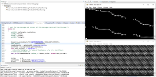

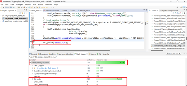

  • Hi Nate,
      We found the mmWave sensor is unstable (happen crash) even if we use CLI_write("DebugMsg: CLI mmWave TimeStamp \n") to print out the log in the long term stability testing. Please help to check the CLI_write() command.
    Thanks.

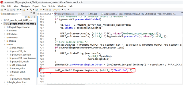

    Can you use mmwave sdk 3.5.0.4 instead of 3.6 and see if the problem persists?
    Nate
  • Hi Nate,
      From build log, it uses mmwave_sdk_03_05_00_04. The full build logs (dss and mss) are attached. Please help to check this issue.

    I think there's some blocking behavior associated with CLI_write(). The demo seems to run when I use UART_write() on the command port instead.
    Nate
  • Hi Nate,
    still happen crash after I try using UART_Write()
    I am unable to replicate the issue. I was able to run the device for multiple hours without a crash. Can you confirm there were no other modifications to the software except the UART_write() lines? What was the environment that you were testing in? Were there many points detected?
    Nate

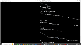

  • Hi Nate,
      In the meantime, we also try to find what's wrong in CLI_write() and find the sensor was happen crash immediately when we executed LogA(). Please help to check this finding.
    P.S. The CLI_write() has similar source code as LogA(). You can also check CLI_write() function.
    Output from teraterm
    Thanks.

    According our finding, the problem should be crash in here (red color text). Can you please help to check this finding?
    void CLI_write (const char* format, ...)
        va_list     arg;
        char        logMessage[256];
        int32_t     sizeMessage;
        /* Format the message: */
        va_start (arg, format);
        sizeMessage = vsnprintf (&logMessage[0], sizeof(logMessage), format, arg);
        va_end (arg);
    Thanks.

    It seems not like as task stack crash issue.
    I try as below:
    sent out 2 variables ( uint32_t and float)  to UART
    pressure test printf 500 times via for-loop
    device works well and no crash.
  • JH,

  • I did one more analysis. Add one line CLI_write() in MmwDemo_uartTxTask()
    As you can see, CLI_write() API take more than 1500 bytes stack size to print out simple char*.
    removing CLI_write() will only take < 400bytes stack usage.
    Please be bare in mind, from memory usage and execution speed point of view, calling CLI_write() API in MmwDemo_uartTxTask is not a good ideal.
    You should use UART_write() instead.
    Andre
