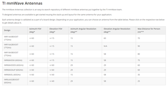

    For a target distance of around 100 meters, how was the IWRL6432BOOST chosen as the right device for the application? The approximate max distance of the IWRL6432BOOST EVM is the lowest across all our mmWave sensor offerings. It's benefits is for low power low cost low intensity purposes.
    You are correct that the only difference between the 6432 and 1432 chips is the frequency band used, and if the same exact antenna pattern and configuration was used, then the max ranges would be practically identical. That bike video uses a 1432, but with a special high gain antenna. If a 6432 was also attached to a high gain antenna you would see similar ranges out of it. The 6432BOOST EVM does not have an antenna optimized for maximum range.

    Regarding the issue mentioned last time, about the point cloud not appearing beyond 10 meters, we have identified the cause. It was due to the parameter "rangeSelCfg" being set to maxrange = 10 on our end. After adjusting this parameter, we can now see beyond 30 meters (as expected)!
