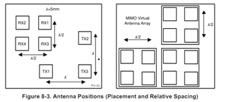

    The figure above shows the antenna positions of the AWR1843AOP chip. Based on this, I'd like to repeat my questions through a few different scenarios.
    Below is the MmwDemo_RFParser_setAoAParams function found in the mmwdemo_rfparser.c file.

    Scenario 1
    chirpCfg 0 0 0 0 0 0 0 1
    chirpCfg 1 1 0 0 0 0 0 2
    chirpCfg 2 2 0 0 0 0 0 4
    When I send the above values
    numTxAntAzim = 2
    numTxAntElev = 1
    outParams->numVirtualAntAzim = 8
    outParams->numVirtualAntElev = 4
    outParams->numVirtualAntennas = 12
    it receives the values.
    Scenario 2
    chirpCfg 1 1 0 0 0 0 0 4
    chirpCfg 2 2 0 0 0 0 0 1
    numTxAntAzim = 2
    numTxAntElev = 0
    outParams->numVirtualAntElev = 0
    outParams->numVirtualAntennas = 8
    Scenario 3
    numTxAntAzim = 1
    numTxAntElev = 1
    outParams->numVirtualAntAzim = 4
    why numTxAntElev value is 0 when the second antenna is switched off. when the antenna positions are examined, it is seen that the first, second and third antennas are aligned on the vertical axis. why does only the second antenna being switched off change the numTxAntElev value?
    We have 3 antennas in elevation, we think that these 3 antennas act as a single antenna in azimuth, but we cannot use it in this way in the algorithm. RFparser code prevents us from using numTxAntElev 3 and numTxAntAzim 1. Is such a restriction correct?
    We also want to run it with two antennas active to send a stronger signal.
    example
    chirpCfg 0 0 0 0 0 0 0 3
    chirpCfg 1 1 0 0 0 0 0 5
    chirpCfg 2 2 0 0 0 0 0 6
    However, when we set it in this way, the numTxAntElev value is assigned as 0. In such a situation, we lose the elevation directly, we are aware that this situation will have an effect on the positioning side. we regulate this effect on the AOA side. I want not to lose elevation information when two antennas are active, how can I fix this situation. I would appreciate if you give a detailed explanation to my questions.

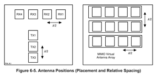

  • AWR6843AOP and AWR1843AOP have the same antenna. The only difference being AWR6843AOP offers 60- to 64-GHz coverage vs AWR1843AOP offers 76 to 81 GHz coverage.
    Please see Table 5-1 in www.ti.com/.../awr6443.pdf
                           AWR1843AOP                                                                      AWR6843AOP
    Since the antenna positions of the two chips are different, shouldn't numTxAntAzim and numTxAntElev parameters take different values? Antenna positions and MIMO structures are different. can you explain this issue?
    example
    when I use these parameters for both chips
    numTxAntAzim = 2
    numTxAntElev = 1
    values are assigned. How is this the same for both chips?
    Is it correct that the MmwDemo_RFParser_setAoAParams function is the same for two chips?
  • You are right, I was mistaken about 6843aop and 1843aop having the same antenna layout. While we look into your issue, what application are you using AWR1843aop/AWR6843aop for?

    example
    numTxAntAzim = 2
    numTxAntElev = 1
    My question is whether there is an error in the MmwDemo_RFParser_setAoAParams function inside the mmwdemo_rfparser.c file. The expression I suspect to be the cause of the error is mentioned above. Please, let's proceed focusing on this specific topic.
    That's another question, I'm looking for an answer to that too.

    I will need some time to talk to the right experts on this function. Would you mind sending the whole .cfg you are using? Is BPM enabled? I am seeing in that function that numTxAntAzim = 2 if bpmEnabled. I will need some time to determine why we set it to 2 for bpmEnabled.
    On your second question, your logic appears correct, and I will need some time to look into that as well.
    Can you check if outParams->numVirtualAntAzim and outParams->numVirtualAntElev seem to be holding the right values for both 6843 and 1843 when you are running it? These are the params that are actually used.

    I've done a little more investigation. So if you look at the code, the MmwDemo_RFParser_setAoAParams function is under an #ifdef for the USE_2D_AOA_DPU. The 2D FFT (Azimuth/Elevation) is what we use in the OOB demo for AOP because both AOP antennas are not intended for high accuracy in 1 of azimuth or elevation.
    The #else condition where we see the values being set "incorrectly" is because we've anticipated the our x843 ISK antenna design to be used with this approach of doing Azimuth FFT, finding peaks, and then Elevation FFT from there. This, for a long narrow virtual antenna array, can provide higher angular accuracy for use cases that require it in azimuth direction.
    Can you check in makefile is "USE_2D_AOA_DPU"  defined? For AOP use case it'd be recommended for it to be defined.
    Let me know if this starts to clear things up and any follow-ups you have.

    First of all, when I define USE_2D_AOA_DPU and send the chirpCfg parameters as chirpCfg 0 0 0 0 0 0 0 0 1- chirpCfg 1 1 1 0 0 0 0 0 0 2 - chirpCfg 2 2 0 0 0 0 0 0 4, I saw that numTxAntAzim = 2 and numTxAntElev = 1 values were assigned in the MmwDemo_RFParser_parseCtrlConfig function, I thought this was not correct for AWR1843AOP. Since the tx antennas for the AWR1843AOP chip are aligned on the vertical axis, I thought that numTxAntAzim = 0 and numTxAntElev = 3 should be assigned.
    In this direction, I sent the chirpCfg parameters as chirpCfg 0 0 0 0 0 0 0 0 1- chirpCfg 1 1 1 0 0 0 0 0 0 2 - chirpCfg 2 2 0 0 0 0 0 0 4 and I assigned numTxAntAzim = 0 and numTxAntElev = 3 in MmwDemo_RFParser_parseCtrlConfig, Then I had to edit the doppler compansation and after making those edits, I ran the sensor and saw that the sensor worked better, especially I saw that there was an improvement in the angle.
    As a result of these tests I have done, do you think there is no error in the MmwDemo_RFParser_parseCtrlConfig function?
    In the AWR6843AOP chip, numTxAntAzim = 2 and numTxAntElev = 1 values are assigned in the MmwDemo_RFParser_parseCtrlConfig function. Although AWR6843AOP and AWR1843AOP antenna arrays and MIMO structures are different, how come the same values are assigned to numTxAntAzim = 2 and numTxAntElev = 1 variables?
    I look forward to your feedback on this subject.
    Onur Emre
  • Hi Onur,
    One more clarification. numTxAntElev are only used if USE_2D_AOA_DPU is defined, so I'm unsure how they are getting set in your tests? In the USE_2D_AOA_DPU case, the virtual antennas in azim/elev are set to 0 as below (because they are unused), and the numTxAntElev variables are not even used.
    Can you confirm that the correct code is being executed based on the #ifdef USE_2D_AOA_DPU in mmwdemo_rfparser.c?
    I am also curious where you are setting the numTxAntAzim = 0 and numTxAntElev = 3. I do not see those being used or defined in that function. Only in the #else case MmwDemo_RFParser_setAoAParams function that is called from inside.
