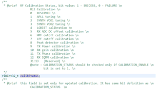

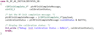

1. We found that both one-time calibration and periodic calibration are turned off. Is there any reason?
2. The CASE RL_RF_AE_INITCALIBSTATUS_SB in the function OccupancyDetection3D_eventCallbackFxn can display the initialization calibration status, but no matter how it is set, the result will be the same (0xffe).
Is the calibStatus data structure updated correctly?

  • HI, ED:
    The actual RF boot-time calibration configuration is done with rlRfInitCalibConfig.   If you search in the SDK folder, you can find it in the mmwave_link.c.  And you can see that the RF init calibration is always enabled.
    /* Are we supporting custom calibration or not? */
    if (ptrMMWaveMCB->openCfg.useCustomCalibration == true)
    * Custom Calibration: Use the application provided calibration mask
    rfInitCalib.calibEnMask = ptrMMWaveMCB->openCfg.customCalibrationEnableMask;
    else
    * Default: Enable all calibrations
    rfInitCalib.calibEnMask = CSL_FMKR (4U, 4U, 1U) | /* LODIST calibration */
    CSL_FMKR (5U, 5U, 1U) | /* RX ADC DC offset calibration */
    CSL_FMKR (6U, 6U, 1U) | /* HPF cutoff calibration */
    CSL_FMKR (7U, 7U, 1U) | /* LPF cutoff calibration */
    CSL_FMKR (8U, 8U, 1U) | /* Peak detector calibration */
    CSL_FMKR (9U, 9U, 1U) | /* TX Power calibration */
    CSL_FMKR (10U, 10U, 1U) | /* RX gain calibration */
    CSL_FMKR (11U, 11U, 1U) | /* TX phase calibration */
    CSL_FMKR (12U, 12U, 1U); /* RX IQMM calibration */
    retVal = rlRfInitCalibConfig(RL_DEVICE_MAP_INTERNAL_BSS, &rfInitCalib);
    And the following two lines are all related to the runtime calibration.  You can find it how it is used also in mmwave_link.c
    calibrationCfg.u.chirpCalibrationCfg.enableCalibration = true;
    calibrationCfg.u.chirpCalibrationCfg.enablePeriodicity = true;
    Sorry for the confusion.

  • HI, ED:
    I think that e2e is misleading.  If you still have doubt on the boot-time calibration control, you can change the following lines to enable partial calibrations and see whether it shows a change in the init calibration status
    Let us focus to solve this question on this e2e thread and please start a new e2e thread regarding your other questions.
    Zigang

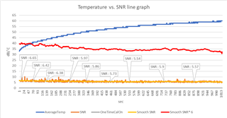

  • Hi Zigang,
    Sorry it took me some time to retrieve the information.
    The same SDK and Demo.
    We use a fixed corner reflector to record the average changes in temperature and SNR every second.
    To observe the results, the SNR was averaged and multiplied by a factor of 6.
    The changes in temperature and SNR are shown in the figure below:
    In this case, when should one-time calibration be triggered?
    For one-time calibration settings, refer to the following link settings
    https://e2e.ti.com/support/sensors-group/sensors/f/sensors-forum/1062129/iwr6843-iwr6843-runtimecalibconfig
    ED

  • HI, ED:
    Usually RX gain change does not affect the SNR.  So, your SNR change is due to the TX gain change.  1dB gain change is not a lot.  You can enable the run-time calibration and see which way works better.  It is really up to the user to decide when to enable run-time calibration.  Usually we suggest 30 degree of temperature change.
    Zigang
