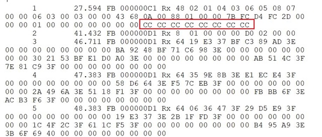

Hi team,
I tried to send the OOB data through the CAN-FD in the 6843 device.
I am able to visualize the data through the Peak CAN viewer. Only the frame header is padded with 8 bytes of 'CC', but not the TLV header or the TLV data.
Please refer the below image of the CAN trace file.
Can you explain why this happened?
I found the code snippet for the calculation of pad-size in the canfd.c file
location: sdk_v3.6.0.0_installation_directory\ti\mmwave_sdk_03_06_00_00-LTS\packages\ti\drivers\canfd\src\canfd.c
    for(index = 0U ; index < 16U ; index++)
                    if(dataLength <= ptrCanFdMCB->mcanDataSize[index])
                        txBuffElem.dlc = index;
                        padSize = ptrCanFdMCB->mcanDataSize[index] - dataLength;
                        break;
                //changes
                if (index == 16)
                    *errCode = CANFD_EINVAL;
                    retVal = MINUS_ONE;
                else
                    /* Pad the unused data in payload */
                    index = dataLength;
                    while (padSize != 0)
                        txBuffElem.data[index++] = (uint8_t)0xCCU;
                        padSize--;
It would be helpful if you explain this part of the code also.
