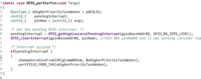

When radar part of the demo (motion and presence detection) starts, GPIO interrupt occurs continuously, even though the line is stable and always high. So we cannot use GPIO interrupt to read the signal.
Later we tried gpio interrupt example (from SDK 5.4 examples folder) to check if we have any problems on the PCB/hardware but it is working without any problems alone.
Is there anyone encountered such problem and have the solution? Thanks in advance.
*Algorithm:

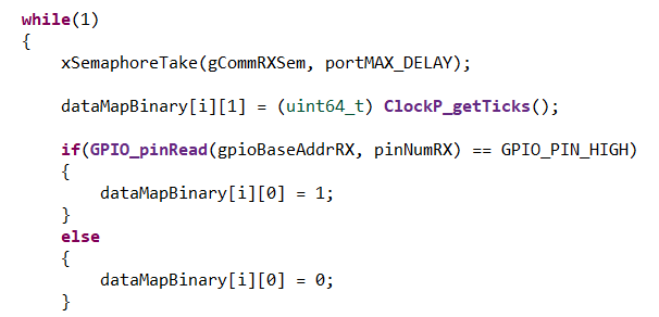

-Sending semaphore from GPIO ISR (trigger type: both edges)
-Taking semaphore on a task and saving GPIO pin state and current ticks value.

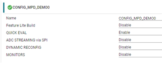

    From the source code of motion and presence demo:
    1- Commented all the stuff about LED toggle.
    2- Disabled low power mode ("lowPowerCfg 0").
    3- Quick Eval/Start is used.
    Not sure which of the above solved the issue exactly, but we have no problem right now.
