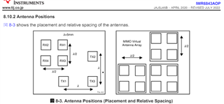

I have a question about *WR6843AOP and *WR1843AOP.
Please let me know why is the layout of MIMO Virtual Antenna Array different between *WR6843AOP and *WR1843AOP.
Please advise.
Thank you for your help.
Shoko

    What I want to say is ”why is the disposition of real TX antennas and RX antennas different between *WR6843AOP and *WR1843AOP. ”.
    Please let me know why you wouldn’t make the disposition of TX antennas and RX antennas of *WR6843AOP and *WR1843AOP the same disposition.
    Please advise.
    Shoko

    The use cases of xWRL1843AOP (a 76-81GHz radar) and xWR6843AOP (a 60-64GHz radar) have different typical use cases due to frequency allocation and regulations. While both being wide FOV antenna arrays, the antenna patterns are tuned for better performance in those particular cases. Additionally, the array for xWR1843AOP takes into account improvements based on customer feedback.

    Regarding the use cases of xWR1843AOP and xWR6843AOP, I think xWR1843AOP is for target at some distance away,
    xWR6843AOP is fot gesture or vital signs at short distance.
    - For short-range applications, is it better to make each MIMO Virtual Antenna Array have a certain area?

    The IWR6843AOP antenna array pattern allows for better angular resolution which is of paramount interest for gesture or vital signs.

    I think that the angular resolution does not improve because the number of virtual antennas is same as xWR1843AOP,
    but the signal-noise ratio improves because the antenna directivity becomes uniformly sharp in both azimuth and elevation.
    Is my assumption correct?

    On the contrary, the angular resolution does in a particular direction with respect to the number of virtual elements. Both xWR1843AOP and  xWR6843AOP have the same number of virtual elements in the azimuth and will thus have the same angular resolution in the azimuth. However, since xWRL6843AOP has an additional virtual element in the elevation than compared with xWRL1843AOP, it will see greater angular resolution in the elevation plane. This will come at the cost of some range, as you mention in your earlier reply.
