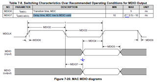

I need clarification about Delay time (MDC Low to MDIO valid) in AWR2944.
From the datasheet, Table 7-8, show the Max delay time is 190ns, but in Figure 7-20 it seems by 300ns. Pls confirm the delay parameters.
