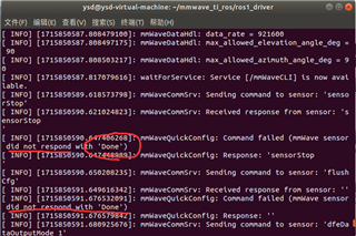

In ubuntu system use ROS driver to read the point cloud information acquired by this radar, but the following situations often occur resulting in the inability to read the point cloud.
Including:
1.I've made no changes to any of the config files, but I'm still getting the problem in the diagram randomly. Note that it is random, and may not report this error when no changes are made.

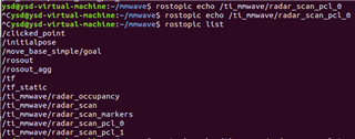

2.Point cloud topics can be read, but topic/ti_mmwave/radar_scan_pcl_0 doesn't emit any data

    1. What gives away what's happening is mmWaveQuickConfig: Response: ''. There is no established communication with the device, whether this is the serial port is "busy" as it is open by something else, is in the wrong SOP mode, or is still running. This is not a ROS, config, or firmware issue, but rather the device is not in the right state in order to be ready to receive commands. Have you been power cycling the device between runs?
    2. Does radar_scan output information as opposed to radar_scan_pcl_0?

  • 1. I didn't power off and reboot, but ctrl+c closed the driver in terminal, and when I enter the command again to open the driver it can't read the data, is this the reason? If I close the driver and want to read the data again, do I have to power off and reboot, or do I choose to wait a little longer for the memory to be released?
    2. Not sure at the moment

    1. You must power cycle the sensor between every run, in addition to restarting the driver. Unplug cable and plug back in.
