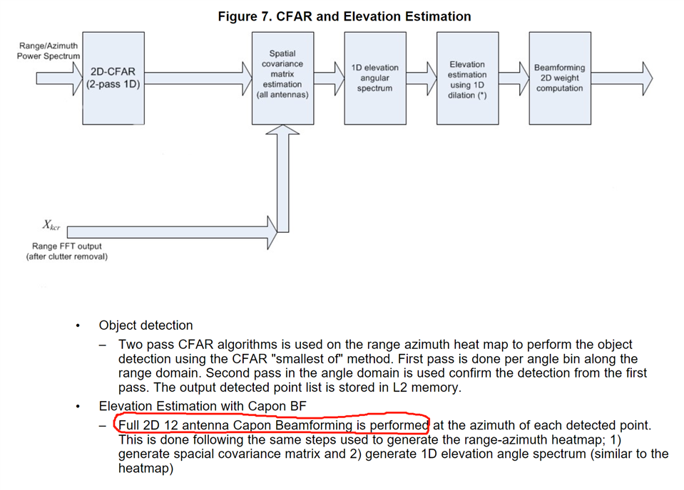

DOC link: https://www.ti.com/lit/ug/tidue71d/tidue71d.pdf?ts=1715850653809#page=8.09

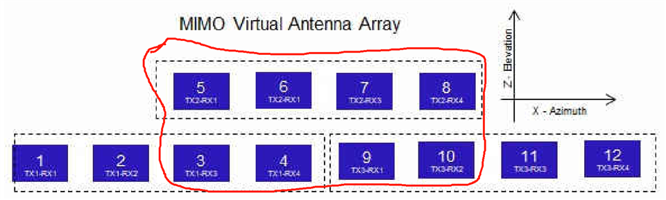

When performing the elevation estimation step, the document mentions using all 12 virtual antennas. Is this correct? What is its mathematical meaning?
My idea is to use a set of four virtual antennas arranged vertically to estimate elevation. Is it correct?
