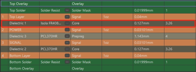

Current stackup of our board:
*Manufacturer suggested to use 0.15mm on the bottom layer to not delay the production (they had no 0.127mm thickness ready at that moment)

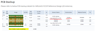

    What is the thickness of your FR408HR? Are you using the dual-ply spread glass application?
    Do you follow the layout guidelines for the IWRL6432? Can you provide a better image of the PCB? Particularly of the GCPW traces? It looks like there may be some damage to the traces which would impact performance.

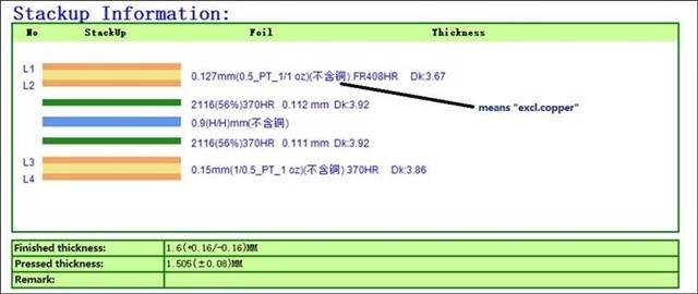

  • Blake,
    Our FR408HR's specs are shown as the table (Stackup Information) above. The manufacturer produced the board based on these specs:
    The issue might not be about the GCPW traces or damages, because we tested it with multiple boards (but the same FR408HR from same manufacturer), and we couldn't detect human after 2 meters on every board.
    Could the problem be about the quality of the FR408HR? Should we get and try FR408HR from another manufacturer?
    Also, we actually don't know about "dual-ply spread glass application", should we specify this to the manufacturer before the order?

    1. Have you referred to the recommended stack up from IWRL6432 FCCSP Reference Design (ti.com) (also shown below)?
    For the antenna layer it is highly recommended to have a 2x1067 (dual ply) spread glass construction for the FR408HR material.

  • 1. Yes, we've referred to the recommended stackup.
    2. We contacted and double checked with the manufacturer that the surface finish is “Immersion Silver” as it is specified in reference design. We also asked about specifications (dual ply, spread glass) of the FR408HR material, waiting for their reply.

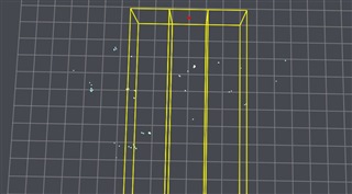

  • Hi Swarnendu,
    Our manufacturer still didn't reply to our question, but we will let you know once we get the reply.
    For the configuration, we've tried it. The range is increasing a little bit, but there are so much noise when we look at the interface:
    There was only 1 person in this situation, but there are so many point clouds as you can see.
    Thanks and regards,
